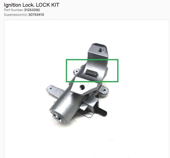

Old Jan 24, 2024 | 12:49 PM
Originally Posted by Angela0719
I just have a problem when I start the car it will go in drive reverse, neutral, park all of it it just will not unlock the steering wheel
Put it in gear. It will go forward and backward, but will not unlock the steering
The steering column is locked - with a "deadbolt" sticking up into a slot in bottom of the steering column (pictured below in the green box). If that "deadbolt" is not pulled down (and out of the slot to unlock the column) by turning the key - you have a bad steering column lock. That part is purely mechanical.
If so - you can order one using your VIN (like you did the keys) and Volvo will manufacture one to fit your existing keys. Takes about the same amount of time it took to get your special order keys. (don't believe that part number, it's just there as an example)
