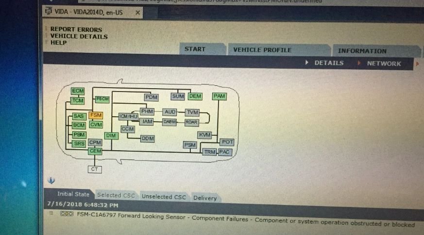

For a 2010 - your best choice would be the factory scan tool/service software. It's called VIDA.. Until 2015 it was available on DVD, and loaded on your CPU. Someone stole it/cracked it so a subscription is not needed. It is easily found on the internet. You will need a DICE unit to interface with the car. I purchased a Cloned unit for $85 a few years ago. You need to find "2014d VIDA/Dice
Now of course your control units won't know that your tie rod is worn, or that your windshield is leaky.
What are the "4 basic repair modules"? As you can see from the screen shot there are a bunch of possible modules (that happens to be a readout from a defective clone DICE unit that will not read the greyed out (low speed network) modules that are installed in that car - that I used to show the DICE vendor the unit he sold me was bad!)
