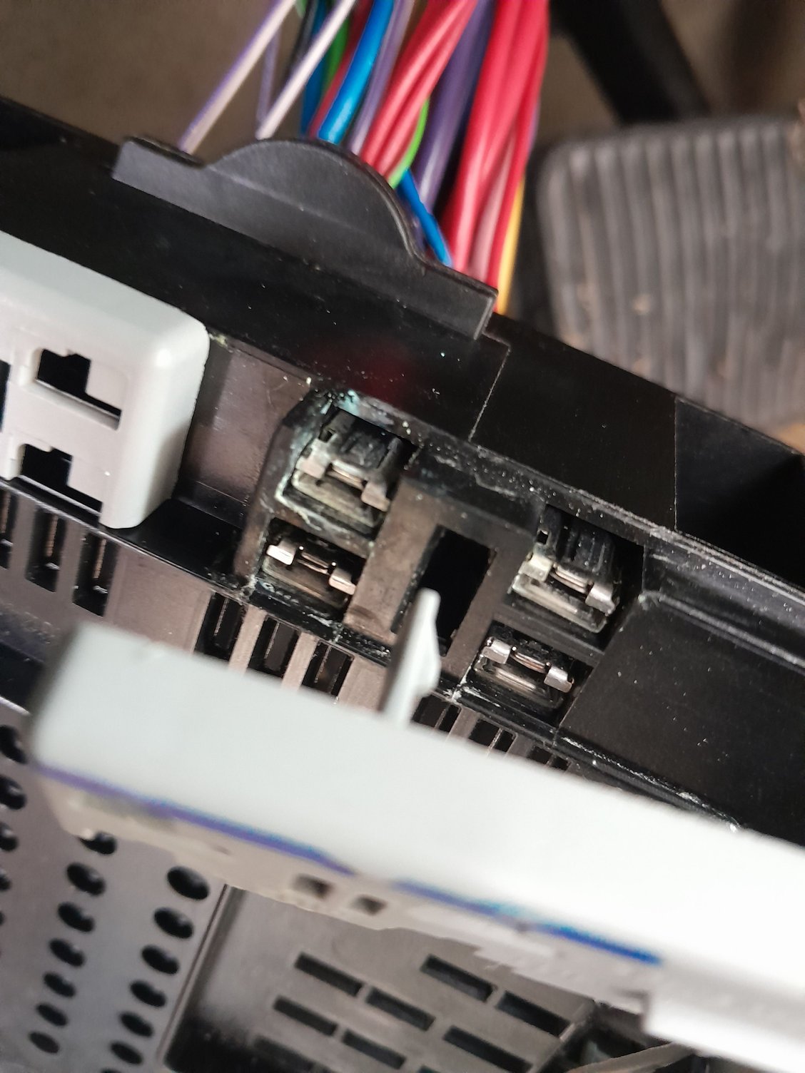

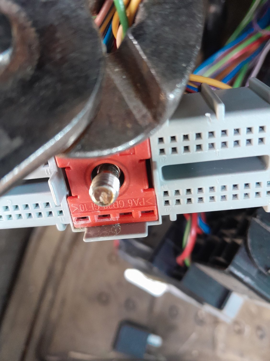

  • I removed the CEM
  • I noticed a little bit of corrosion, mainly at the bottom behind and on two of the relays
  • I also noticed some corrosion on the part that is plugged in directly behind the 10mm nut/bolt

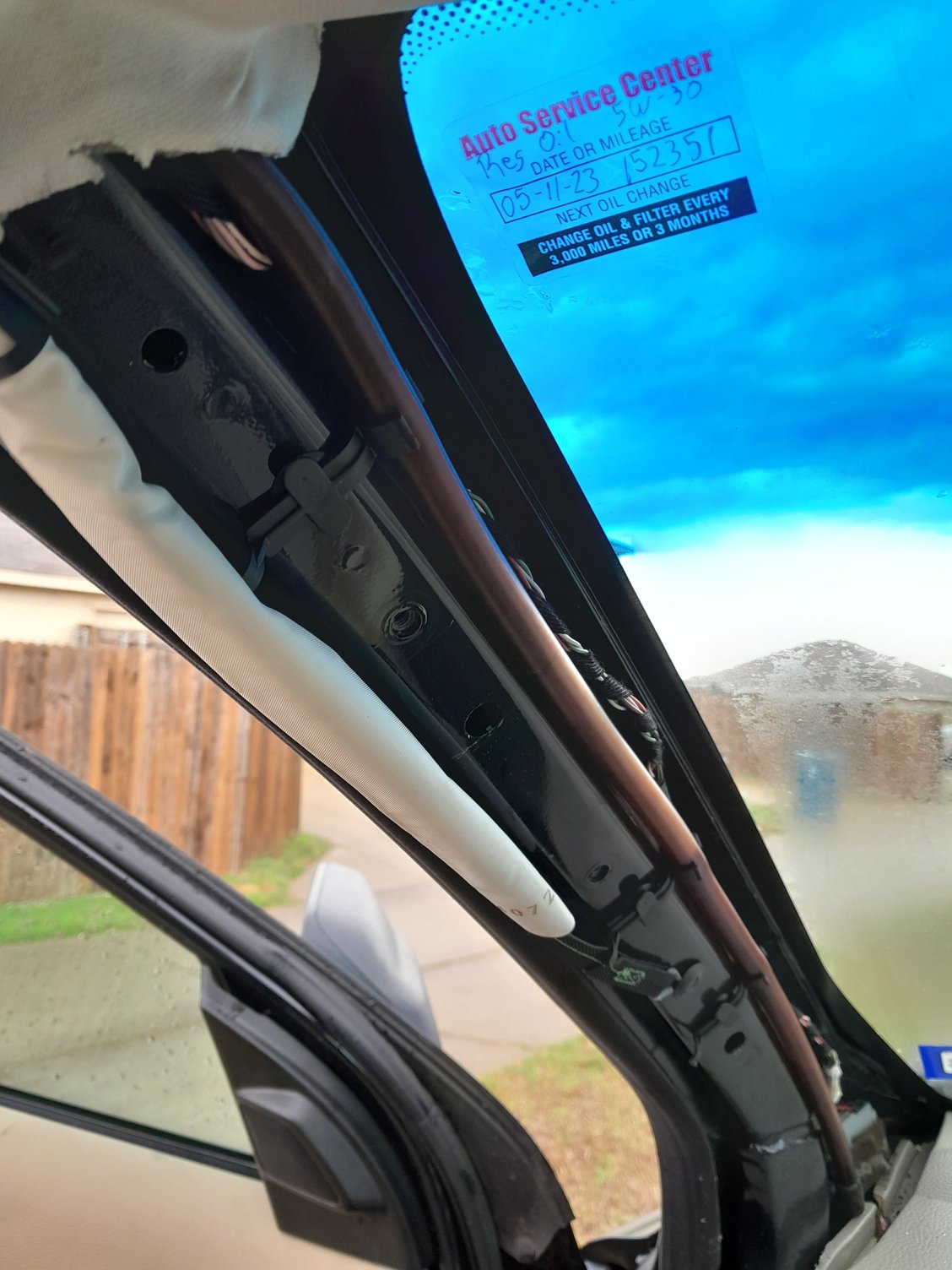

  • The sunroof drain hose leaked for months during last year's rains resulting in water above the carpet. (It has all been vacuumed out and the Drain Hose Valve has now been replaced)

  • Based on anyone's experience, has the CEM been affected heavily requiring replacement by XeMODex?
Here are a few images below with captions below them:
Some corrosion in the CEM Relay area (technically at the bottom where the fuel pump relay goes)
Some minor corrosion on the connector near the 10mm nut/bolt.

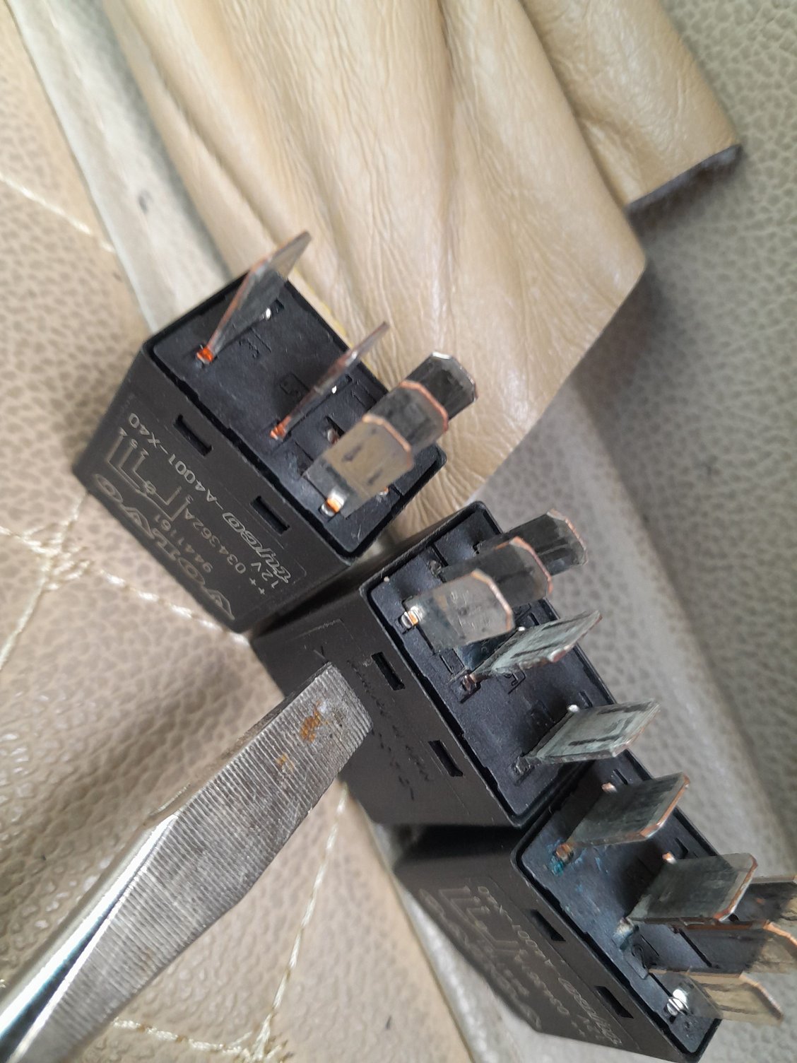

Some visible corrosion on the relays (One of the two on the right was in the fuel pump relay plug.)
Below is a photo of the Sunroof Drain Hose with the new valve added on:
The sunroof drain hose valve was previously broken, causing inches of water to build up in the floorboard and above the carpet.
