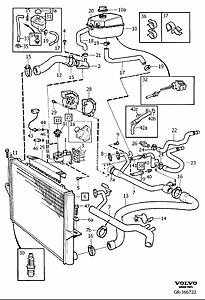

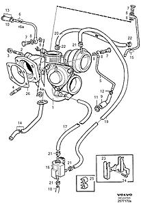

Hello, I just got a 1998 Volvo V70GLT with 2.5L turbo. I got it from a friend who said it had a water leak. I found the leak this morning. It is a hose from a coolant line to the middle of the turbo. The hose busted at the hose clamp that attaches to the coolant line(#7 in coolant picture, one of two nipples on one side). The hose seems to be pretty squishy. All the coolant lines seem to be soft and pliable. The car has 222,944 miles when I bought it this last weekend. I used almost 5 gallons of water to get it the 15 miles home, I refilled the coolant reservoir when the low light would come on. I had seen some people make comments about maintenance to the water pump. How would I know if I need to do that? What other maintenance do I need to know about? Thanks!
