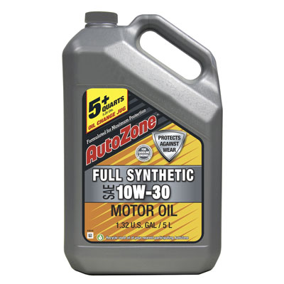

Synthetic oil is the only thing you should be using. The engine is designed to run on it so it's the best way to go. Most climates the recommended weight is a 15W40. If it's the cost, try looking for the auto parts stores sales where you get a bargain on a name brand if you buy the oil and filter together. Usually shaves off around $8 or so. Also orielly and autozone have house brand synthetics at a really good savings and they aren't much different than the name brands. But ,,, try to stay away from Fram filters. There have been a number of people (myself too) who have had issues with lifter noise on start up when using Frams. The check valve that should hold oil in the engine and allow for faster pressurization of the system seems to not work that well.
These guys actually test the different oils:
O'Reilly Full Synthetic 5w20/5w30 - Bob Is The Oil Guy
Attached Thumbnails What else to do when doing Timing Belt-oil-autozone-synthetic.jpg   What else to do when doing Timing Belt-oil-oreilly-synthetic.jpg
