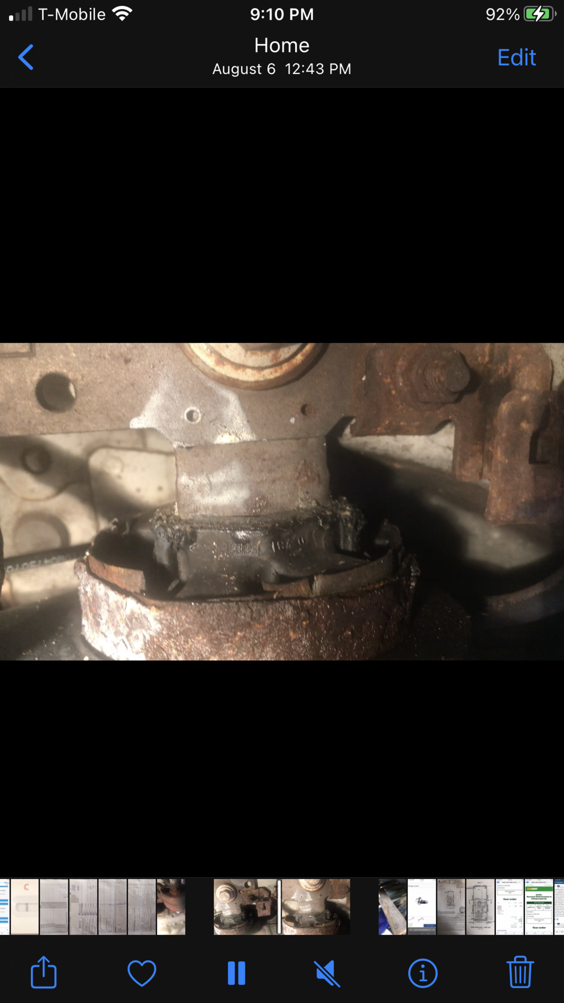

Check the control arm bushings. Which are hided behind the shield covers. I just replaced them last summer. I took me couple years to find out the true culprit. If not fix it, you will have uneven wear on tires. Inner side of tires worn out very fast.
