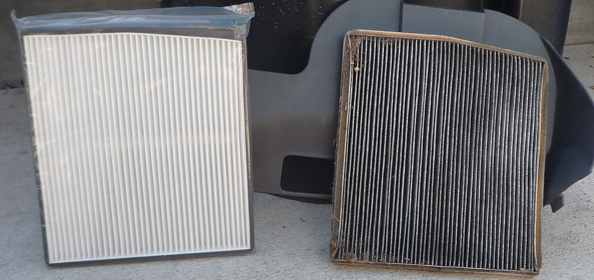

Swapped out cabin air filter. Air conditioning suddenly started smelling foul. First time, so I did a web search for the location. This yielded 3 different:
* under the bonnet, at the back/passenger side
* under the glove box inserted horizontally toward the driver side
* under the glove box inserted upward
Turned out to be the last one (for my V70 XC 2001).
One of the videos showed the access panel falling away in the fellow’s hand after pulling out the 2nd bolt. I knew that was likely to prove special effects for me. Sure enough, extracting the panel was the hard part of the operation. Pull up, down, left, right, jiggle, bend, force, twist—anything short of bust. The mating with the dorsal panel, which I thought might be the key turned out to be a hoax. The key was at the other end.
Old filter was so dirty that leaf debris was falling out as I extracted it.
Strangely, the bolt attaching the panel at the outer/door end was missing, and I found out why when I inserted one and it contacted with thin air. Definitely not the only point where bolts have been superseded in favour of ill-fitting parts and crossed fingers.
When I was checking the first location, the cowling could only be lifted after detaching one of those proprietary Volvo plastic bolts. Once I punched out the core piece of the bolt, it went flying, becoming a sacrifice to the God of Mechanistics. Hate those damned things.

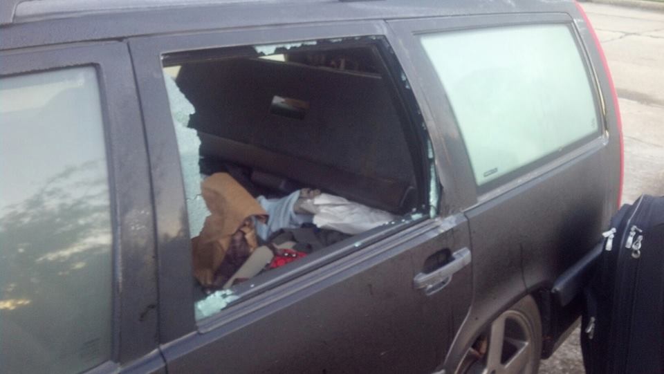

Replaced a broken door window.

AH, I am so sorry man! Someone try to grab something and break it or did it shatter when you closed it?

Stopped to visit a friend while traveling and some bone head smashed the window on an unlocked car and took my old damaged laptop, which is locked down. SMH
