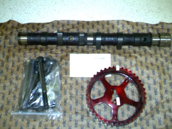

OK, it's not my Volvo, but the Geo got one hell of an engine modification today. I purchased an Economy camshaft (Metro XFi Grind) and a 10 degree advanced timing gear for it recently....

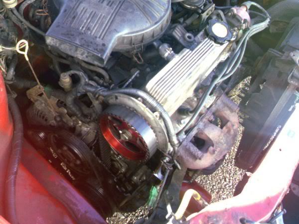

I installed them in the car with a new cam seal and could not believe how much power this delivered! The car has great low-end power and I can run with my distributor fully advanced with no ping (spark knock) even on 87 octane fuel. Here is a pic of the new cam gear installed.....
Now I might be able to reach my goal of 60 MPG at 60 MPH.
I talked to thew guy who does custom cam grinds and he said that a vehicle with 2 cams like our Volvo cars would also benefit from a custom grind. The thing is with a DOHC setup you only need to modify the exhaust cam. I am trying to crunch some numbers and see if I cannot get and extra cam for the V70 and have him custom grind it for better fuel economy. I know it sounds crazy and if I screw up, I could bend valves, but I am a determined individual.
You can get more HP out of a turbo car by using a set of NA cams in it.
Higher lift and more duration.

I'm jealous of that timing belt as it looks way more easy to inspect and change than any I've seen in years. Without reading your post, and just looking at the picture, I thought I was somehow looking at a camshaft for some DOHC 6 cylinder engine. Looks like you have room to install some sort of fabricated exhaust header, too. I suspect general aftermarket performance parts are rather scarce for a 3 cylinder Geo/Suzuki. But maybe I'm wrong.

Performance aftermarket parts are not very popular for the 3 cylinder. One place makes a header for them and you can do turbo swaps from the old Sprint Turbo models also. Working on the Geo is way easier than working on the Volvo.
