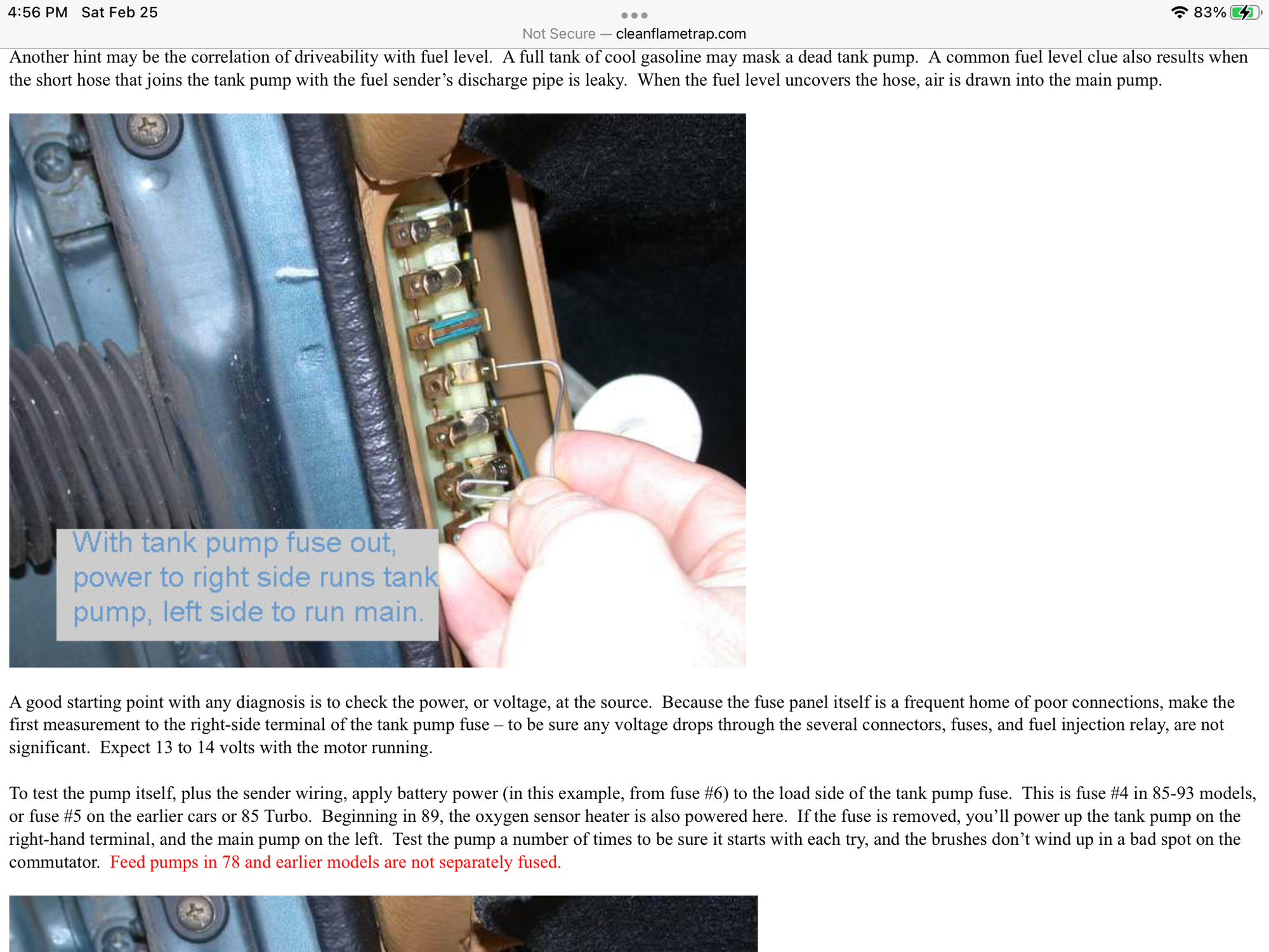

Replaced both fuel pumps on the wagon and she is runnuing pretty well. I noticed the main pump sounded like it was working too hard and determined the prepump (in tank) isnt running.
I removed fuse 5 and jumped it to fuse 7. The left side of 5 runs the main, also received a “spark” on my paper clip. When I test the right side of the fuse to jump the pre pump I hear nothing running nor is there a slight spark on my paper clip. Does this mean there is no power to the pump? Shouldn’t I at least get the spark when I make the connection in the fuse box?
Just wondering if i need to start tracing wires or go directly to the pre pump.
The relay has been replaced as well.

So I got to test fuse 5 with my test light. I removed the fuse and with the car running the left side lit up but the right side did not. Where should I go from here. The fuel gauge does work if that is pertinent info.
Thanks again,
Old Feb 25, 2023 | 03:27 PM
If you remove the fuse and you have power on one side but not the other -
The side with power (on the fuel pump circuit) is getting power from the fuel pump relay.
The side without power - is going to the pump. There will be no power on that side of the fuse holder.
With the fuse in, do you have power at the wiring to the intank pump in the trunk?

I will check that next. I was under the impression that one side powered the main pump and the right side would power the pre pump. Must of misunderstood the information from cleanflametrap I found. Thanks for continuing to respond
