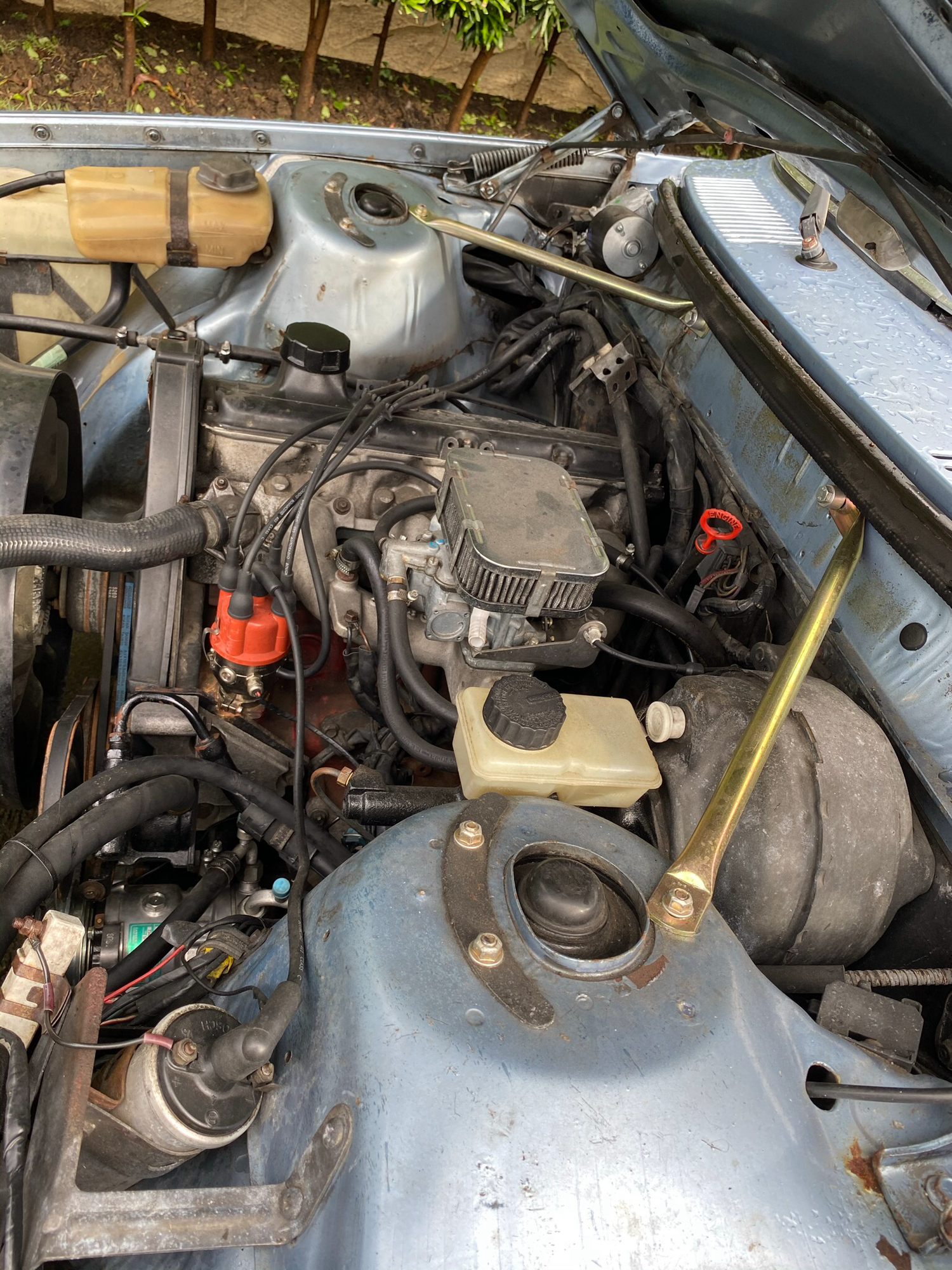

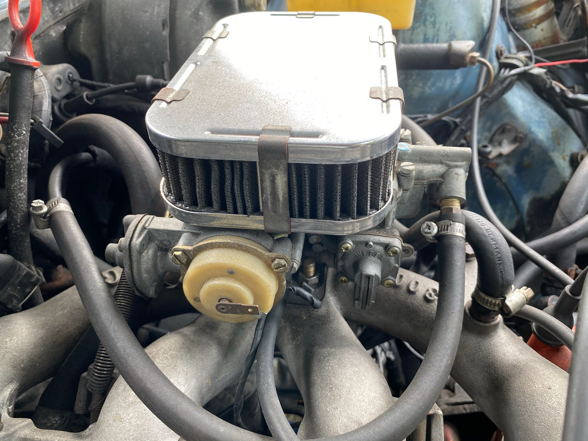

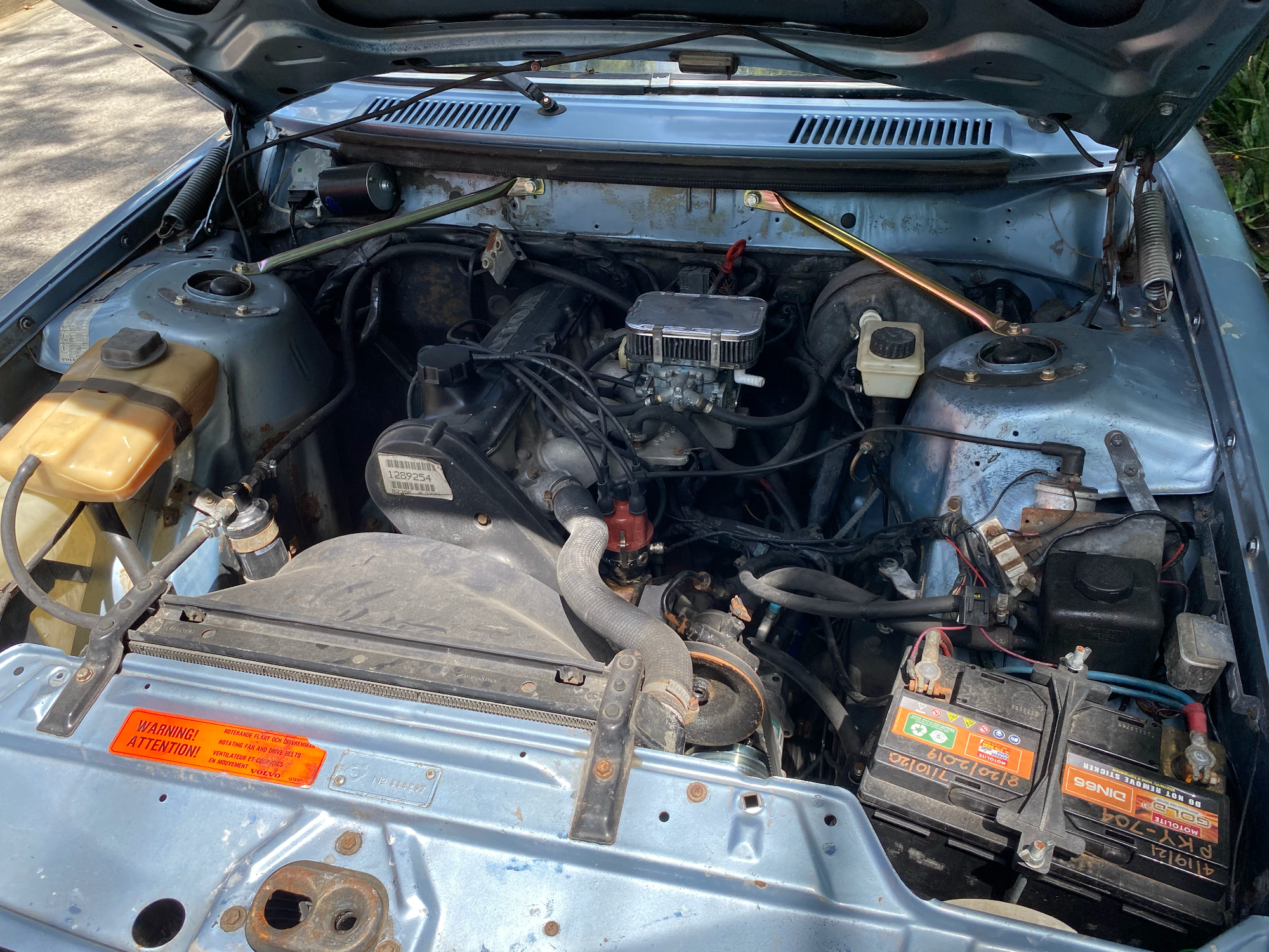

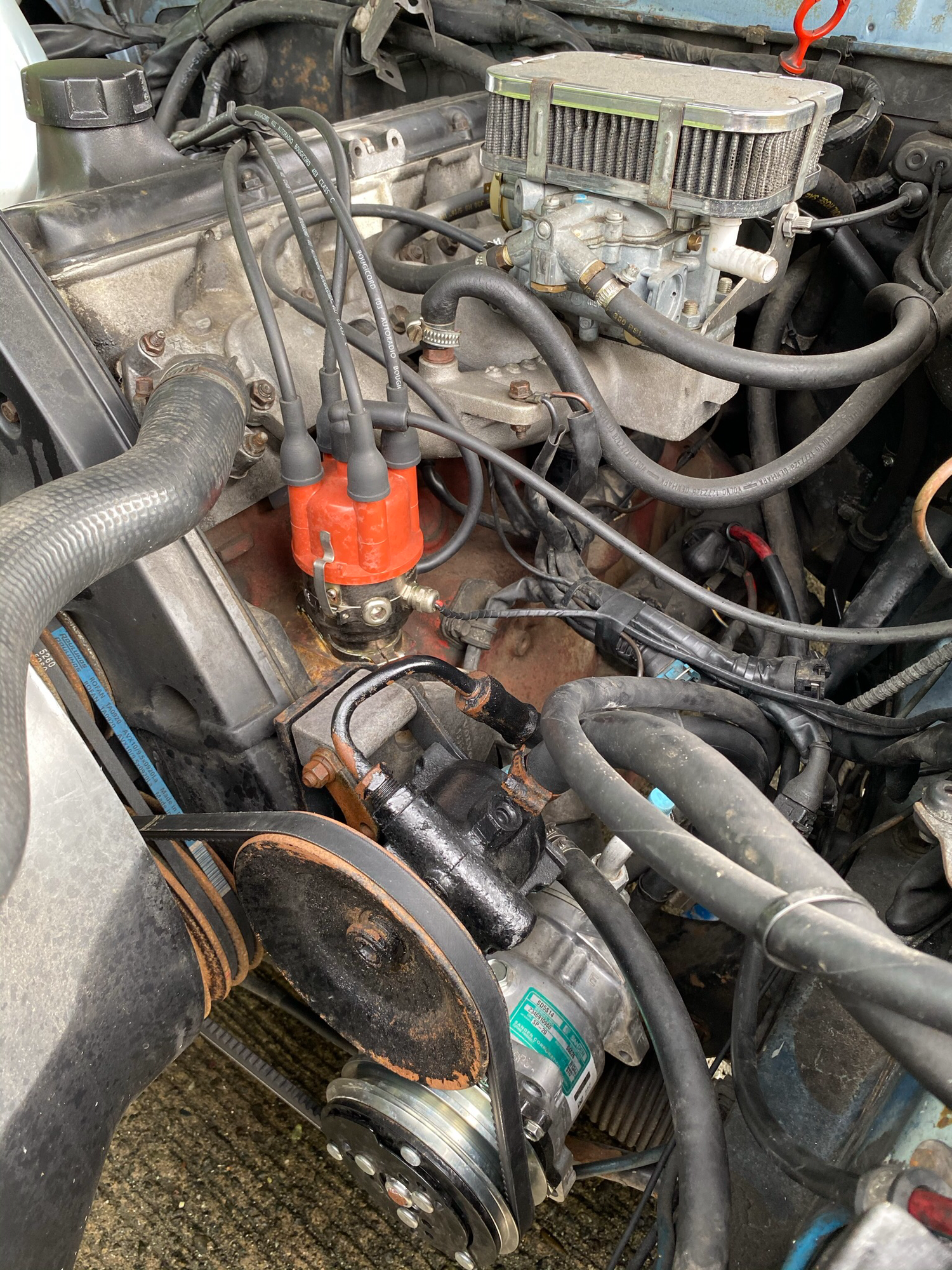

I deleted the original inline fuel pump and retained the in tank fuel sender. I also installed a generic filter before the carb. You need to install a fuel overflow return line from the carb back to the tank. I replaced my distributor with a stand alone unit from 123ignition.

Weber 32/36 DGEV with Pierce manifold
123ignition electronic distributor
