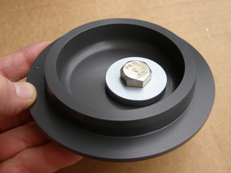

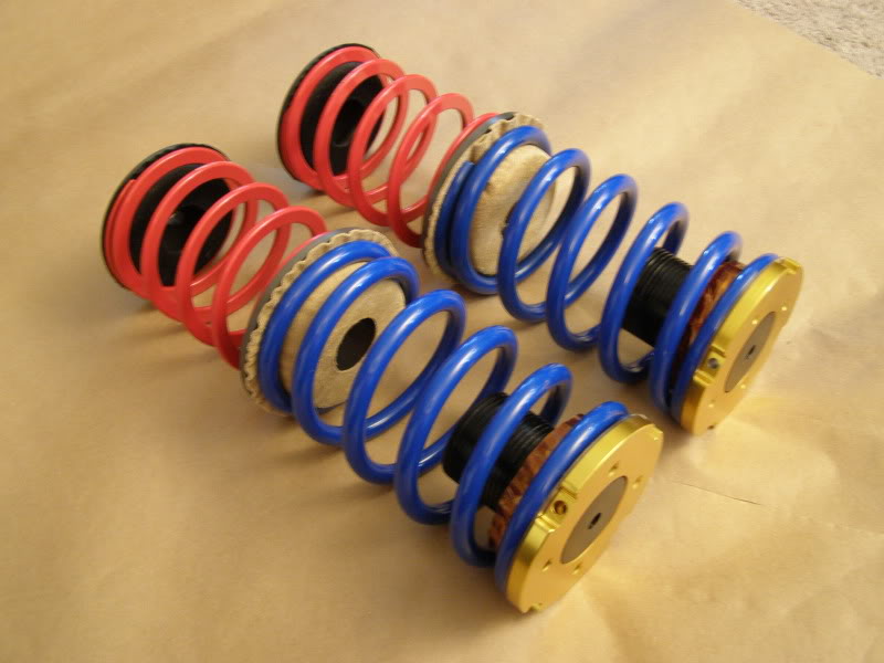

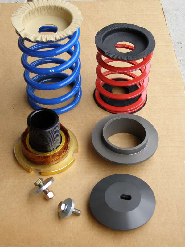

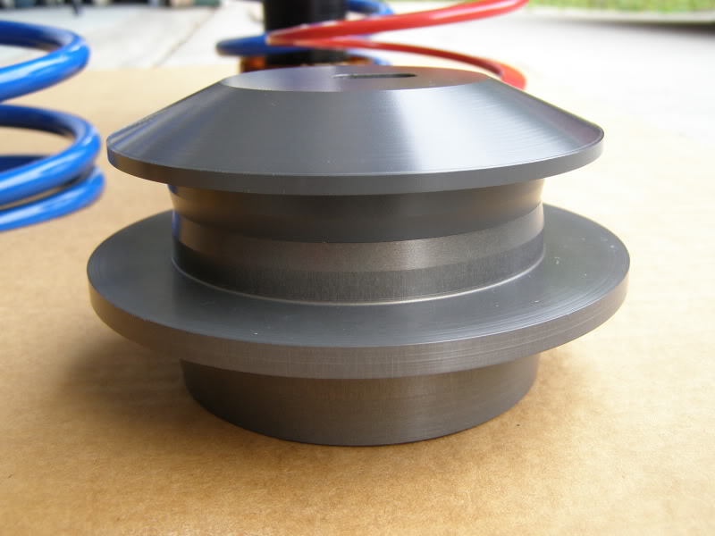

Picked up the parts from the anodizer today. It is a clear type3 "Hard" anodize.
That is the offical last piece for the car to get on the road now.

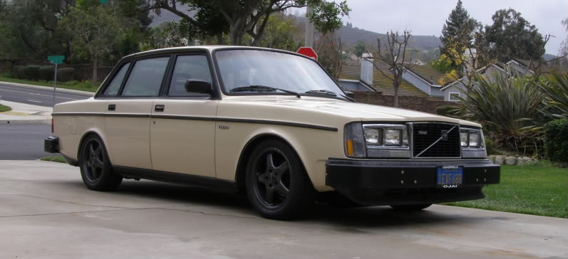

Took the car out for the first time around the block.
There is a few things that need to be adjusted. The front struts are on the softest setting right now. they will need to be adjusted to a firmer setting. rears could use a little more compression, but that is not going to be changed right now.
Brakes need to get broken in.
a few more little things here and there and it's good to go. pics will follow in the new year.

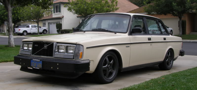

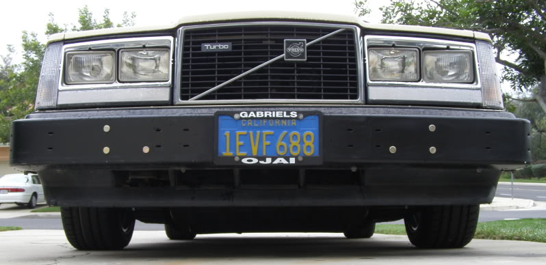

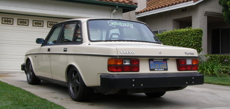

Couldn't wait for pics, so here is some quick ones. final ride height will change slightly.

Old Dec 16, 2010 | 06:58 AM
  #67
Looks awsome. Is that car fast?
Old Dec 16, 2010 | 10:53 AM
  #68
washdup's Avatar
Joined: Jul 2009
Posts: 44
From: Ventura, SoCal
I like everything but the big sticker on the rear window, but to each his own. Nice work!!!
Old Dec 16, 2010 | 02:54 PM
  #69
TIPSP's Avatar
Got Boost?
Joined: May 2008
Posts: 3,473
Likes: 4
thanks
umm... power wise? nope. not yet.
through the corners? maybe. haven't done any real testing yet becuase of the messed up alignment.
thanks man. the sticker is not permanent.

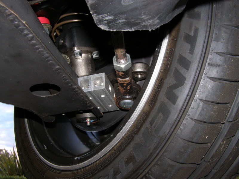

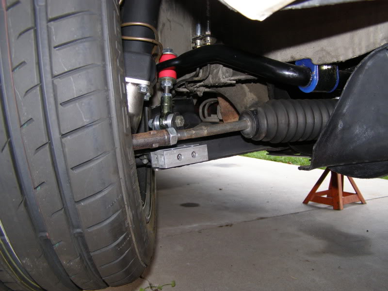

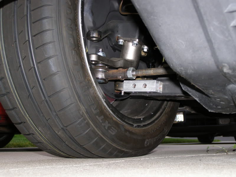

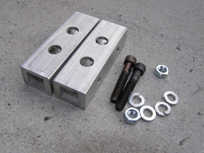

Small update.

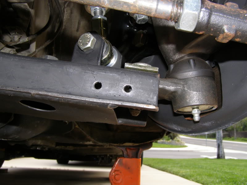

The quick steer spacers allow for quicker turning, but because the end point has shifted closer to the origin, the tierod travels along a smaller radius simulating ~2.5 lock to lock, but the rack is set for 3.5 turns lock to lock. that is a problem for the rim hits the swaybar if you try and turn all the way. hmm... a limiter is now needed.
Simple solution with some aluminum parts found:
not pretty, but functional.
Total cost: free - time spent

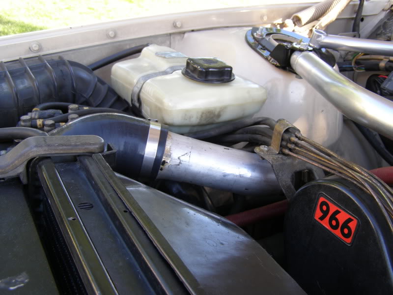

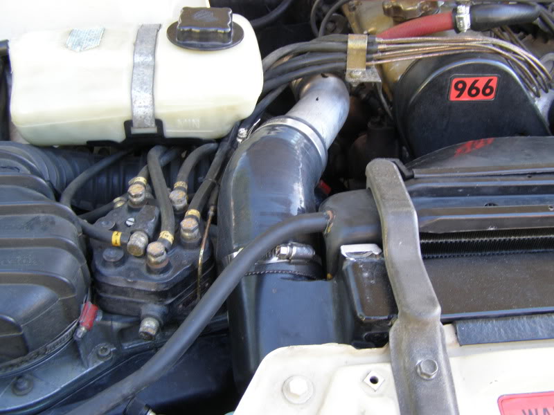

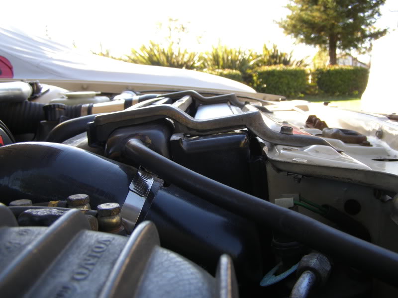

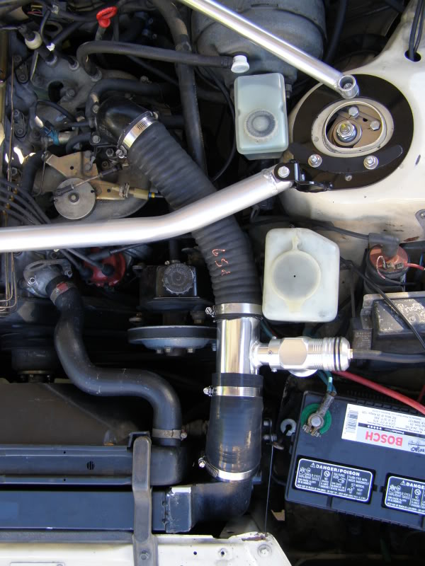

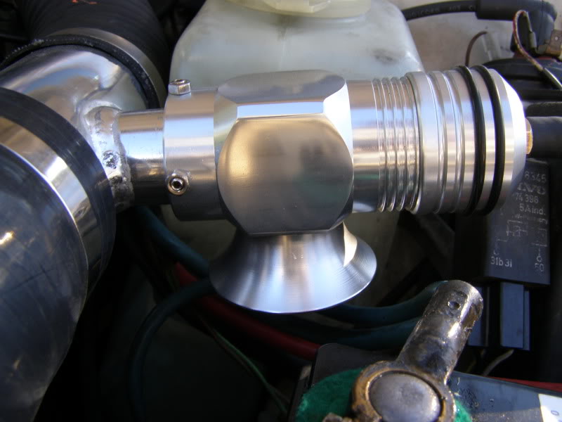

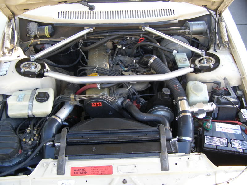

Finally found some free time to put the intercooler in.
NOw it needs a real gauge, and more boooost

Fine-looking work. How's it running?
Old Feb 13, 2011 | 01:42 PM
  #75
TIPSP's Avatar
Got Boost?
Joined: May 2008
Posts: 3,473
Likes: 4
Thanks man. It took us all last weekend to remove, modify, and install everything. Now the pipes need paint, or polish. not sure yet.
It runs pretty good right. Just really needs more pull in first. An Exhaust, cam, and 10psi will help there.

From: Dallas, TX
That's an NPR i/c, right? Regardless of whatever it is...looks great! You need an RSI cam...IPD at the least.
Old Apr 8, 2011 | 02:25 AM
  #79
TIPSP's Avatar
Got Boost?
Joined: May 2008
Posts: 3,473
Likes: 4
Yep, NPR ic. THanks man.
