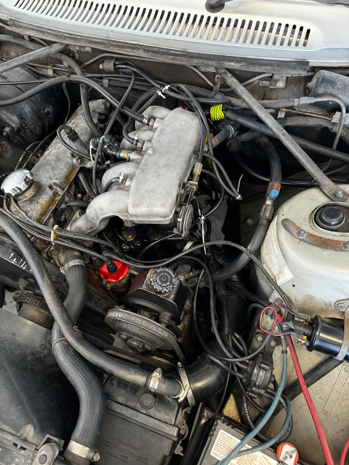

Replaced vacuum hoses mostly all around

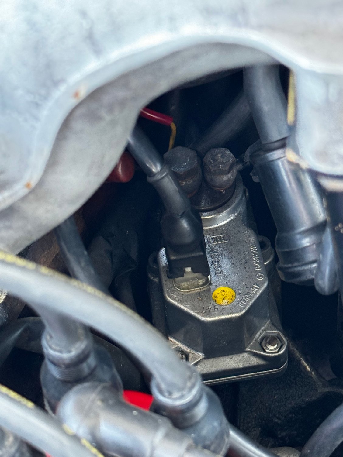

when I unplug the fuel distributor connector as shown, nothing changes. Is this supposed to happen?

pictures attached for the wiring of vacuum hoses and fuel distributor.

5. What's shown in your picture is the Control Pressure Regulator. What plugs into it is simply 12volts. That powers a heater to change the control pressure during the first couple of minutes after starting. The CPR and the air valve act as the choke - to give the engine more fuel and more air when cold.
