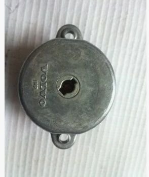

Take the plastic cover off the steering column. Undo the 2 screws holding the electrical portion of the ignition switch onto the steering column lock. You can use a screwdriver to turn the switch (on, off, start) and figure out what's not working.
