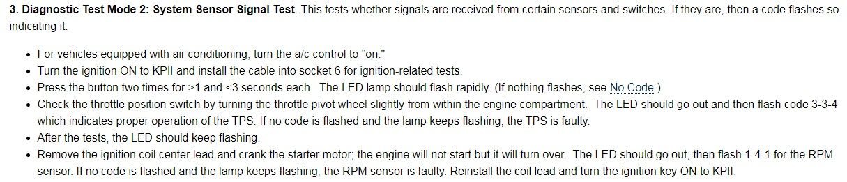

Using the on-board diagnostics, the EZK gives a 1-4-1 (or it could be 1-1-4, I don't remember) code for the CPS which means it likes what it's seeing from the CPS.

Nope. When I jumper pin 2 on the diagnostic box (the pin for ignition testing), press the button two times for 1-3 seconds each and observe the flashing LED, and then crank the engine over, it gives me code 1-4-1. Which means that the EZK is reporting that the CPS is working properly.

Got it. My shops or I never spent much time with diagnostic mode 2. How about when you simply check codes using mode 1 in both the ign and fuel systems? Usually if there are no codes we'd start looking at items that won't show codes. Connections, shredded wiring, ign amp, relays, etc. Then when a tech would say "Needs a control unit", I'd drive 15 minutes to my friends used Volvo parts warehouse, pick one up - tech would try it - then he would find the real problem.

It doesn't currently have any fault codes stored, but at this point I've replaced ALL of the components after the EZK that could be causing a no-spark (plugs, wires, cap, rotor, coil, and powerstage) with brand new OEM units. I know the coil is getting 12V on both terminals with the key on but the powerstage is not getting the pulsed signal on pin #5 while cranking. So clearly the CPS signal is getting to the EZK, but it's not putting that out to the powerstage. I tested all of the wires on the powerstage connector for continuity with the correct pins on the EZK connector, and all of them tested good. So I know it's not a broken wire there.
Another thing that makes me suspect the EZK is that when I try to use the ECU diagnostics for the crank position sensor, it doesn't seem to work. I do the whole process to get into the ECU diagnostics and get the flashing light on the black box, but then when I crank the engine over to generate a signal from the crankshaft position sensor, nothing happens. But I'm not sure if simply cranking it is good enough to generate enough of a signal for the ECU to pick up on, or if the engine has to be fully running (which obviously I cannot do at the moment).
