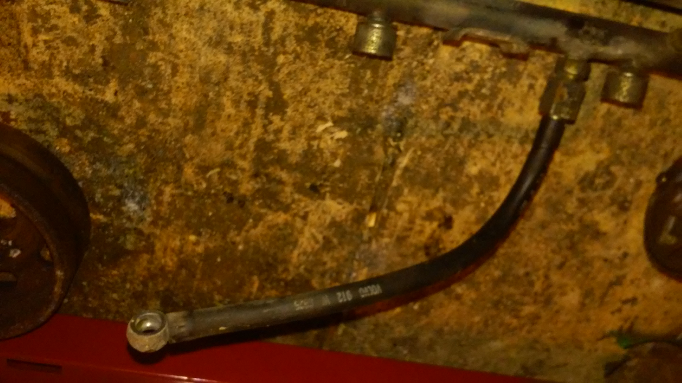

The hose Im referring to is not apart of the flame trap, its a small hose that runs near it.Name:  RGdvrSp.jpg

Are you sure it is oil as it looks like a fuel line. Maybe the return line.

Just checked, thst is a fuel line and based off the smell, it was gas spraying everywhere.
I should note the car struggled to build fuel pressure during testing. Niw I just need to find where the other end is for the hose.

Looks like the main fuel line that feeds into the fuel rail... You cannot use any fuel line to replace it, pressure is too high... New, I don't know, must be pricey, but what choice is there? May be get it used if there's a p -n-pull place near you. The little plastic flame trap seat is easily available.
So, was that the leak source, fuel, not oil?

The original source was oil, the new "puke-leak" is gasoline. The nearest PnP doesnt let customers in (you just guess and Pray they remove the correct part). Given this is fuel related, I'm willing to pay extra money if it means a better hose, safety means more to me than saving $3.
http://ww2.justanswer.com/uploads/en...or_picture.jpg
Id you look at this picture theres a small hose on the lower left between the injectors, I'm thinking (and hoping) thats what I broke.

That fuel line runs from the fuel rail ( next to #4 injector) to the cold start injector ( where my finger is in pic) underneath the intake manifold.

I can read the numbering "912 W 8825" on the fuel line in the picture on previous post. Those pictured parts are from a '89 740 with a NA b230f.
Hopefully thats all that I need then, thank you for the pics. It'd be nice to know that the injector works!

The fuel leak is fixed so far if temporarily, used a piece of yellow hose with clamps from the local O'Reilys, spotted a leak in one of the low pressure lines that we fixed as well (I never touched this line, it was just dry rotted).
So yes it was the cold injector line that I screwed up, I'll keep my eye out for any oil leaks.
