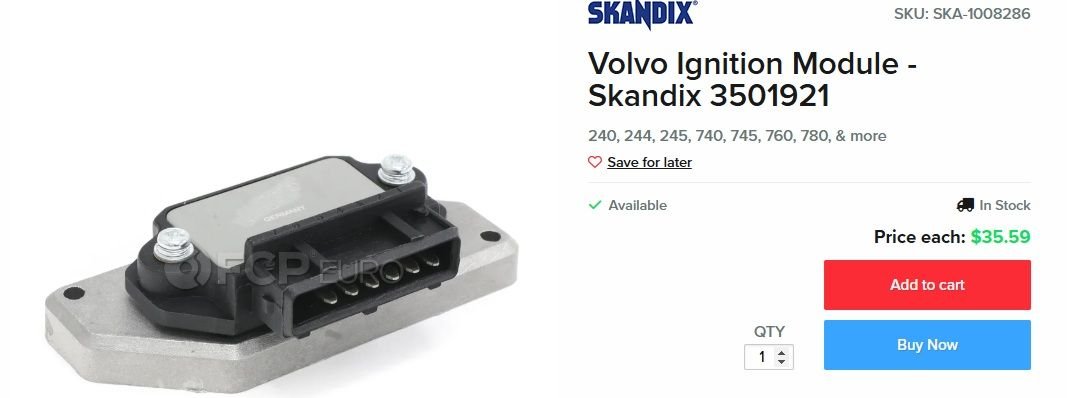

Do you have fuel pressure? Do you have spark? (if no spark)
The ignition amp is a failure point. Have replaced a few. Bad connections inside or outside - moving the connector has made some cars start.

I have no spark.
What's your thoughts on testing the ignition amplifier?
Thanks
Old Mar 4, 2025 | 08:40 AM
Originally Posted by Build
I have no spark.
I (or any of my techs) never found a test for that amp. It does not set any codes either. We would test with a known good part. - after checking connections, power and ground to all related components, wiggling wires at the amp while trying to start, making sure there was no pulse at the coil with a test light, making sure the injectors are firing (that would mean the crank sensor is working), etc.
I'm sure if you knew what the inputs were you could test all of them - but it was so much quicker to just plug a replacement in!
