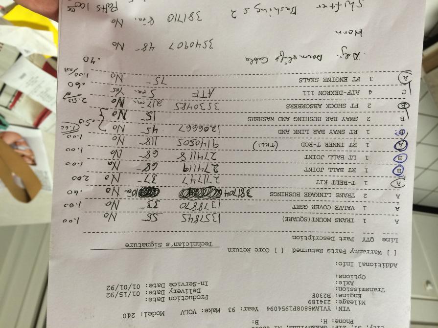

Default Update:
Here is the video I shot of the car today. I think it's in pretty good shape. If I attached it correctly, the estimate from my (very expensive) Volvo dealer is attached too.

Wow everything looks and sounds great. The bearings and tie rods are a common issue for these cars of this age. It's just to be expected. Personally I wouldn't pass it up. But, I did notice that your temp gauge is running a bit high. Is that accurate?
Old Aug 20, 2014 | 01:52 PM
yeah, temp gauge is way high, shoudl be near dead center unless the car is on the verge of overheating. now, it could jsut be the gauge itself (or the stupid regulator circuit) is fubar.
I saw a yellow idiot light flickering but I couldn't tell which one. might just have been the 'bulb out' idiocy.

I'd not buy because of the rust! Rust is like an iceberg, you only see 10%. The rest, it's a neglected, unloved, worn out car with a lot of deferred maintenance. Body is rusty, interior is ripped, engine overheats, suspension needs a ton of work. If you spend all the money to make it NICE, it'd be way more that it would be worth... It's worth $600 to me...
