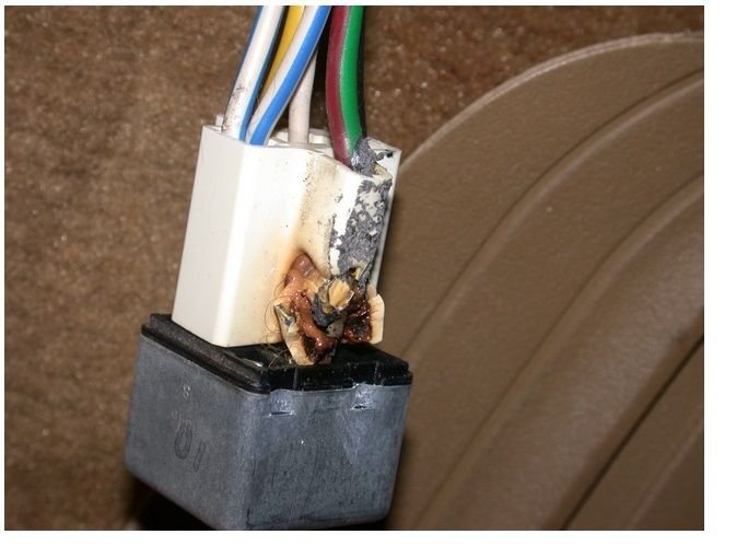

That square relay is needed to turn the lights off when the key is off. 1986+ 240s can leave the headlamp switch on all the time - and the lights will turn off (even if the switch is on) when the key is turned off.
In the earlier cars 86-90? it was mounted near the left foot rest. Later cars mounted near the central locking relays. Common is a melted connection at the relay as pictured below.
https://www.brickboard.com/RWD/index...724&show_all=2

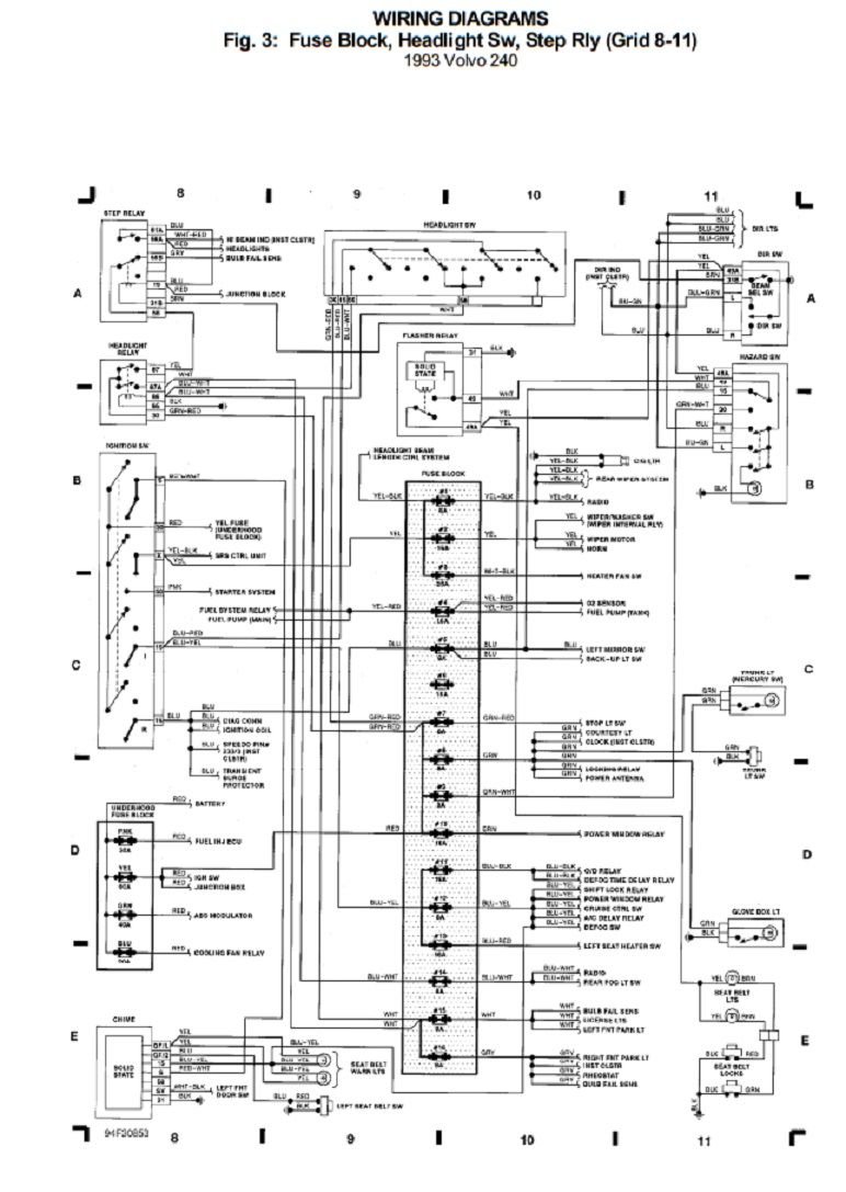

Wiring diagram is not from a green book - do you have power at the red and green wire at the square relay? Power when lights on at the yellow wire?
https://volvo240-260.com/Wiring%20di...240%201993.pdf

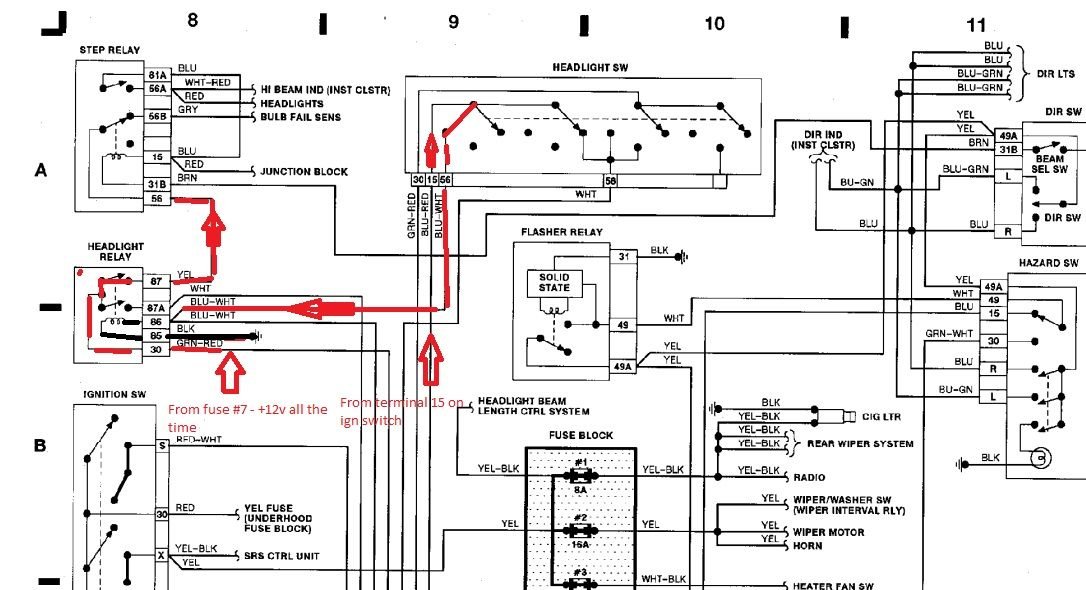

YES - I understand that. from the diagram below, I've tried to add current flow. Let's trace power to the step relay/headlamps
The blue /red wire from terminal 15 on the ignition switch sends power to the headlamp switch. (up arrow in middle of page)
Do you have 12v at the blu/red wire on the headlight switch with the key on? (other wires at the switch - grn/red = power all the time from fuse #7, sends power to the White wire with switch in position 1 or 2 to the white wire for the parking lights. Do you have power at the white wire and the bottom 2 fuses for the parking lights when switch and key is turned on?)
If power at the blu/red wire do you have 12v at the blu/white wire on the headlight switch with the switch in position 2? (if so the headlamp switch is good)
That blu/wht wire goes to the solenoid coil on the square headlamp relay inside the car. Do you have 12v at the blu/wht wire (terminal 86) on the square relay with key and switch on?
Note the black wire provides ground for the relay coil. Do you have a good ground connection for the relay on the black wire?
The grn/red wire on the headlamp relay has power all the time from fuse #7. Do you have power at fuse #7? Is there power at the green /red wire at the headlamp relay?
The points in the headlamp relay when closed send power to terminal 87, The yellow wire. Do you have power at the yellow wire with key and headlamp switch on?
Moving onto the step relay under the hood - Do you have power at the yellow wire/terminal 56 on the step relay with the key and switch on?
Do all these wire colors match what you have on the car? (this is not a Volvo diagram so don't know how accurate it is)
Hope this helps.
