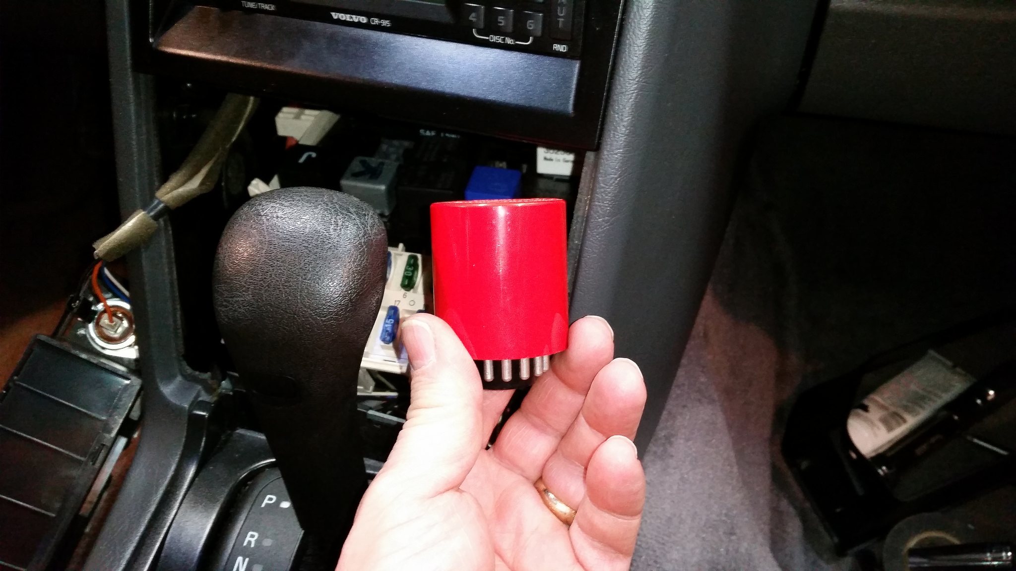

just a minor problem. The car has no brake and high mount lights when the brake pedal is depress. Check #4 fuse with test light- ok. check power at brake light switch at pedal - none. After reading and research, there is a relay for the bulbs that could be the problem. Is it located behind the fuses. I see a red round relay way back behind the fuses. I remove the cluster to reach it with no success. How do I get to it. Thanks

The piece of dash directly above the fuses can be removed. That will give you more access.
There is a plastic plate/cover over the cigarette lighter. Remove that cover and you will see a Phillips head screw in the upper left corner. Remove that screw and you can then remove the dash piece.

thanks. Is this the most likely cause of the problem..
Attached Thumbnails 1995 940 -  no stop lights-25434701463_2c792b5680_k-1-.jpg

I'm not sure about the likelihood but it's possible.

Travel to a local u pull it salvage yard. got the relay for $3.00. Replace the red bulb failure relay/sensor behind fuses. all lights operating normally.. thanks for your help dytha99 ..
