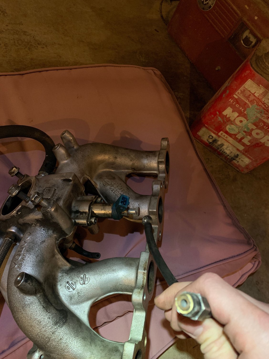

Hi again, I’ve hit another road block in my project. After getting a new fuel rail for my 240, I’m having an issue with this little hose connecting the fuel rail to the intake
Here’s a pic of the line and where it mounts:
Does anyone know how to loosen this sucker? i’ve already managed to break it off the old fuel rail, and i’ve tried PB blaster and WD-40. No luck. Or what’s the name of this part called? any idea where i can get another one?
Thanks to all.

does that connect to the cold start injector or something else?

It might, it connects to something with a connector to the harness that runs under the intake manifold
Old Jan 27, 2020 | 07:29 PM
the cold start injector is in the middle of the picture of your manfiold, with the blue rectangular connector.
what year 240 is this? the 1991 in your signature ? if so, 'fuel pipe', part 1317061. and you probably want 2 each 'gasket' 947620 for the banjo fitting, and 1 'gasket' 1271488 for the throttle body to intake manifold. 'gasket' 1378879 for the intake manifold to head.

It shouldnt be that hard. Definitely badly seized. But make sure you are also turning them the correct way! Try doing a submerged soak overnight in pb blaster or transmission fluid.
remember the big nut turns the smaller one is static.
If you do it and your facing it turn big nut away from you while holding the smaller nut still. Try vice grips.
Goodluck and regarding the gasket pieces, ****** those from the junkyard!!

Also do it with rubber end facing your left not right!

Did the soak, it worked! Thanks! but now I need a new part, as the threading on the new fuel rail is too small for the bolt on the hose oh well
