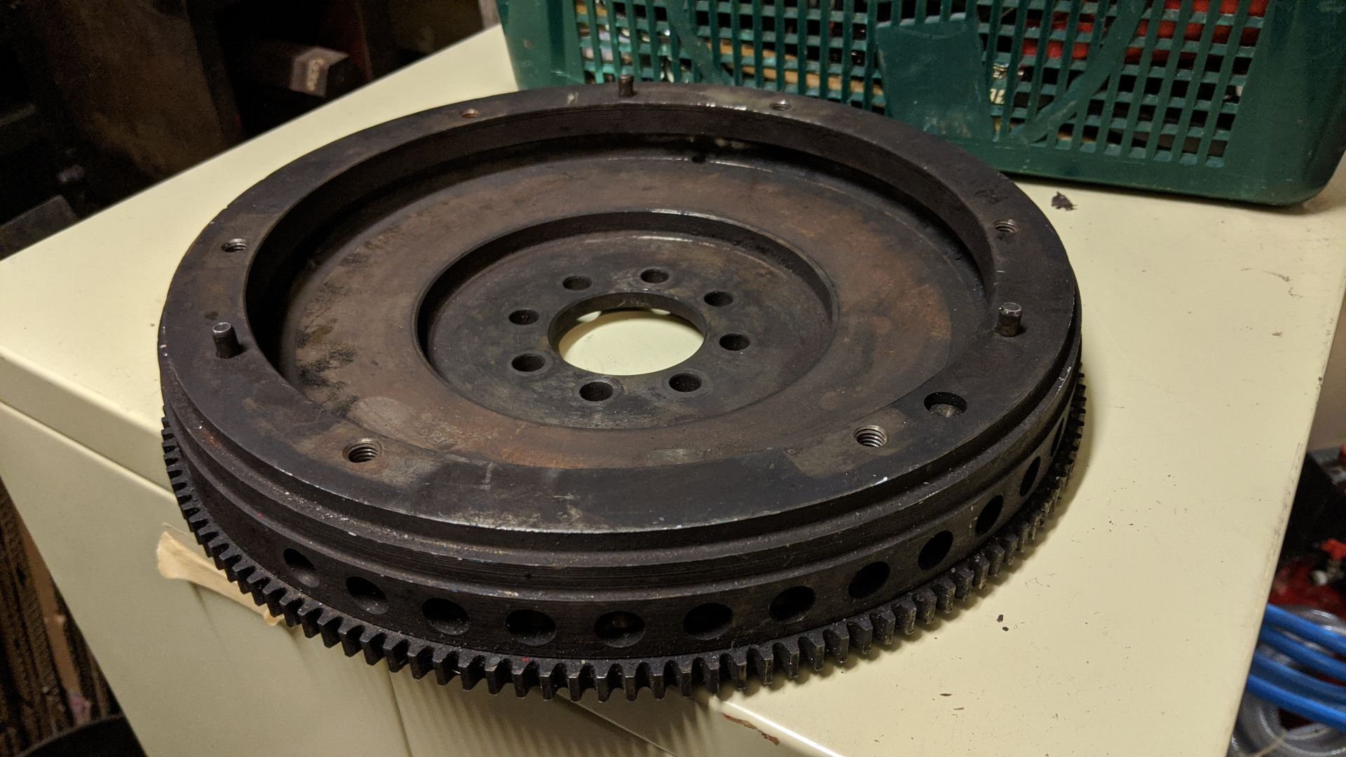

I’m in the process of starting a manual swap on my 1993 volvo 240. I have all the parts but am wondering if I have the right flywheel. I have a late style dog dish one but I noticed some have holes around them for I assume the speed sensor and some don’t. Mine doesn’t have the holes and is just a smooth edge, is this the correct flywheel? Thanks!

You need the one with the holes. The holes are necessary for the crank position sensor used on the later fuel injection system (LH 2.4 or LH3.1).

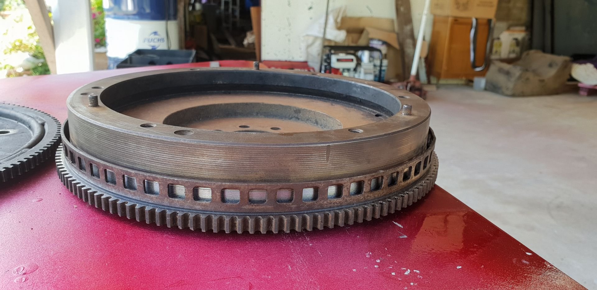

When I google the lh2.4 ones with circle holes and rectangular holes come up, I was wondering which one is correct for my application, thanks!

Can't say which one is correct for LH2.4 since I only owned 240s with an automatic transmission. The one with the square holes looks like the flex plate on the automatic so my guess would be that one. However, maybe someone else can chime in here.
