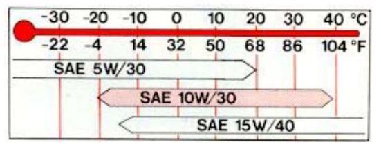

edvard's Avatar
Joined: Nov 2017
Posts: 178
Likes: 6
From the Owner's Manual: https://volvo.custhelp.com/app/manua...1993/model/240
Page 74: https://volvo.custhelp.com/app/manua...ual/om_id/1146
