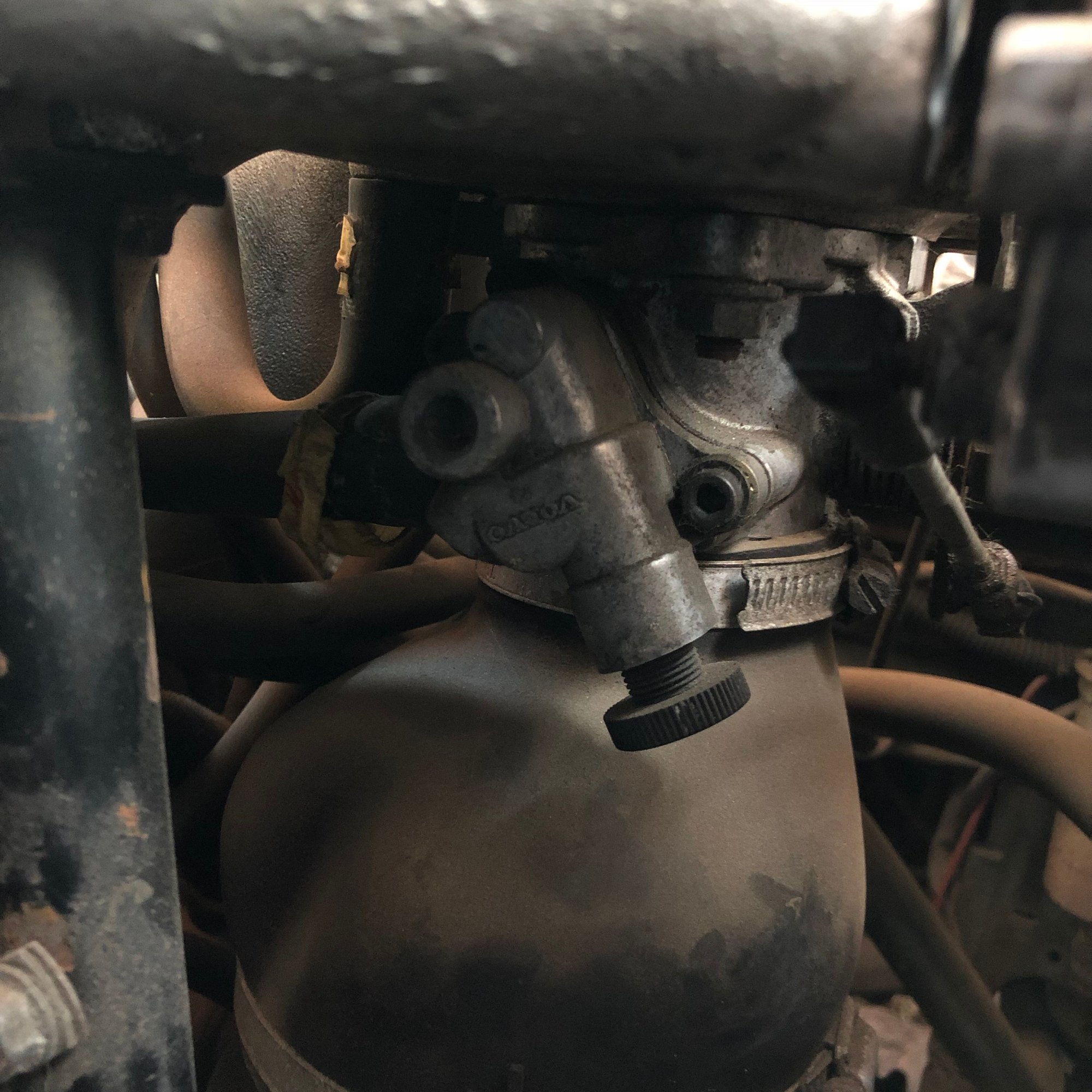

These were the best that I could do. There isn’t much space around it for photos from the side :/

to begin with, on the first pic there is a broken off vacuum line... that does not look right. to where it goes i have
no clue....
Old Oct 12, 2018 | 03:17 PM
ok, that looks a B21 engine (2.1L most likely), with KE-Jetronics injection, aka CIS-E. these are pre-1982....
there is a cold start injector in the middle between the intake runners 2 and 3, this helps the engine start when its cold.
right above (in your top view picture) said cold start injector is a broken off vacuum hose. with this open, the engine is going to have an awful idle.
LEGEND!! Thank you sooooo much! I am thoroughly impressed you have made my weekend!!

it is in a ‘88 T3 Caravelle to be precise. Unfortunately the photo cheated a wee bit and that hose that looks like it just stops, disappears further down and connects to something else. I have had a look at the wiring and hoses in that area and everything seems to be as it should.
