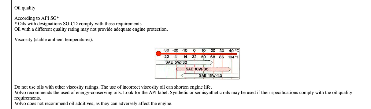

Per your owners manual:
That means if you are driving in conditions where the temperature is above 68 degrees Fahrenheit you should be using 10W/30.

+1 on trusting the owners manual. There's a lot more options now vs when the car was made - on our 2000 S40 I run 5-30 in the Winter and 10-30 in the summer using a big brand high mileage full synthetic. High mileage products have seal softeners which help older cars. Given you can see plenty of sub-zero winter days (well not this past winter :-) and 90+ in the summer, I'd recommend changing oil spring and fall and use the weights appropriate to the season.
