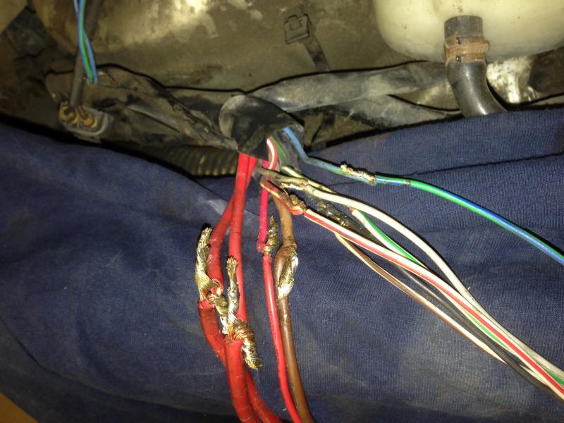

This week I started tearing into my 740, and found some things I would have rather not found…anyways looks like the the previous owner hacked up the stock wiring harness pretty good, so I'd like to get it back to stock format.
At least it was hacked up in a way that I know which "mods" were his…wait till you see these joints. Hilarious.

4. Not really a question, just wanted to show you the awesome joints:

Looks like someone gave it the ol' chop and then they had to get it back together. You good with a soldering gun and heat shrink?

The actual engine wiring harness should be pretty much the same. You got LH2.4 fuel injection and EZK116 ignition by the looks of things, so the engine wiring harness should be the same for an 89 740 naturally aspirated car with the same setup.
This is a master diagram for my car: https://skydrive.live.com/redir?resi...t=photo%2c.gif
So it includes all variants of the car for all markets in the 1989 model year. Different fuel injection, ignition, turbo, nonturbo, north American lighting and euro, etc. You can find your systems on it and follow the color codes.
This one is a little different: https://skydrive.live.com/redir?resi...t=photo%2c.gif
It is just the LH2.4 and EZK116 systems for a naturally aspirated car with a few modifications. I used this diagram to run a 1994 940 turbo engine on an engine stand. The only differences were the injector ballasts (only on turbo cars, so they are not on the diagram) and that the coil gets power from the radio suppression relay (or injector relay). As a note, dotted lines are for optional stuff, like egr (only in California).
For using a non turbo diagram on an engine 5 years after mine it seemed to all match. One or two colors may have been different, but if you can trace both ends you can make it work.
