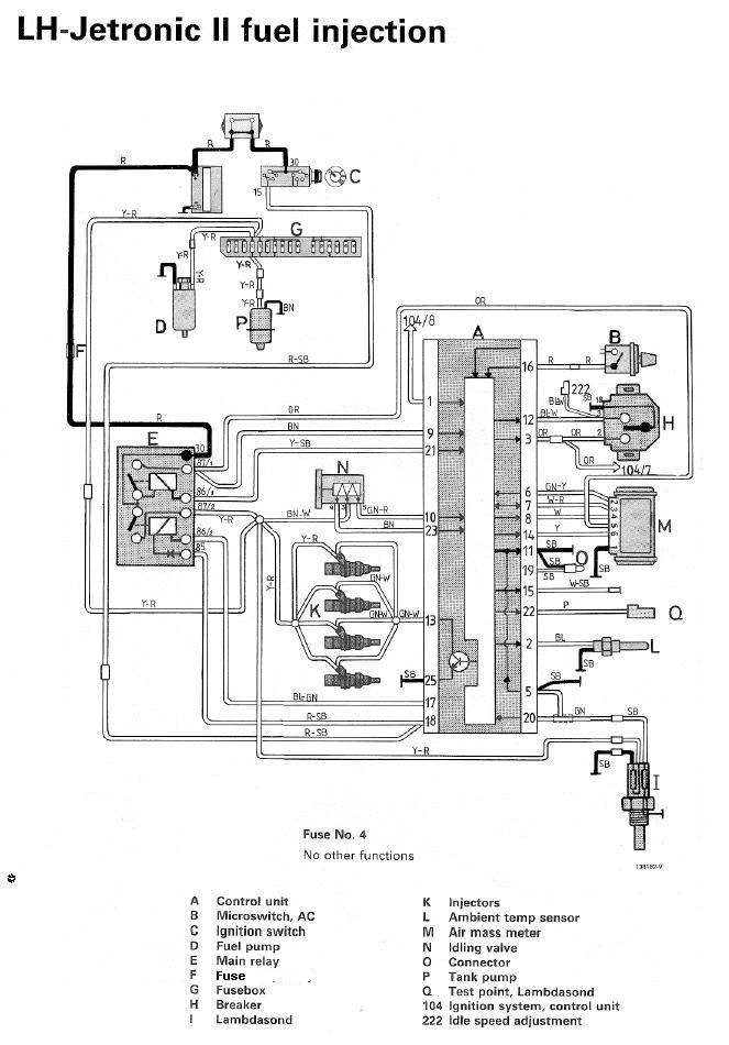

Are you grounding the blue-green wire on the FP relay?
Attached is the LH2.2 diagram. With the key on make sure ECU has battery voltage on pin #18, red-black.
Pin #1 should have some voltage on it while cranking.
It would be nice to know if the injectors are opening, using a noid light or by measuring the voltage to one of the injector plugs.

I Tested the continuity of pins 5, 11, 19, and 25 for grounds, and all tested good. Yea i think it was your thread. I did replace the computer, but it was a used one from a wrecking yard, so i'm not sure if it's good or not. It's doing the same exact thing the old one was though.
Yes i did ground the blue green wire on the FPR, and the pump runs like a champ when it's grounded, or bypassed... but not at all any other time.
I tested pins #1 and #18 for voltage as described, and they both had power.
I was going to test the injectors with a test light by rolling back the rubber boot and hooking it up, however, i cannot find my test light... i tested it with my multimeter though, and at no point during cranking did the tester show any signs of getting power. It stayed at 0.00v the entire time.
Out of curiousity, what does pin #1 control?
Yeah I guess thats right, you would need the jumper installed to see any voltage on the injectors because they are tied to the pumps.
Pin #1 is the ignition pulses from the ignition ECU - the pumps won't turn on until the pulses are present.
My guess is the ECU is still bad ....
