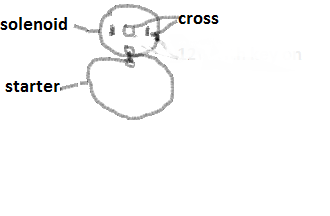

I read your post again,lets start over.You have forced me to use my extraordinary paint shop skills
I think you may have crossed the wrong terminals.You need to cross the center terminal with the right hand spade terminal on the solenoid. Did the engine crank over?If it doesn't crank the starter is bad,if it does crank you may have a problem with the park-neutral switch.

Hey dan sorry to confuse u, i should of put a comma after ignition because i saw your screen name turbo, thats what i meant, sorry. Your saying i should jump the center post with the one that has the little green wire on it, thats the right spade post

This is what the drawing looks like to me
