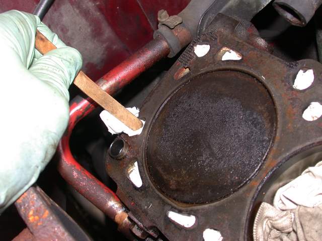

Ok,,There is a hose on the rear of the head under the intake,that goes down too the heater control valve,then into the firewall.
How the heck do ya get too that hose on the head?
Is there a specific procedure to get at it? Things to take off as in supports or something..I can't even see it very much..lol
I know it's there and the hose blew out just past the clamp.

One heater hose is under the intake manifold, as mentioned. Remove the manifold for access. The other heater hose attaches to the heater return pipe alongside the exhaust manifold. Best to disconnect the hose at the firewall and remove the red heater pipe in order to attach a new hose at the rear. But then you've got the seal at the water pump to replace as well.
