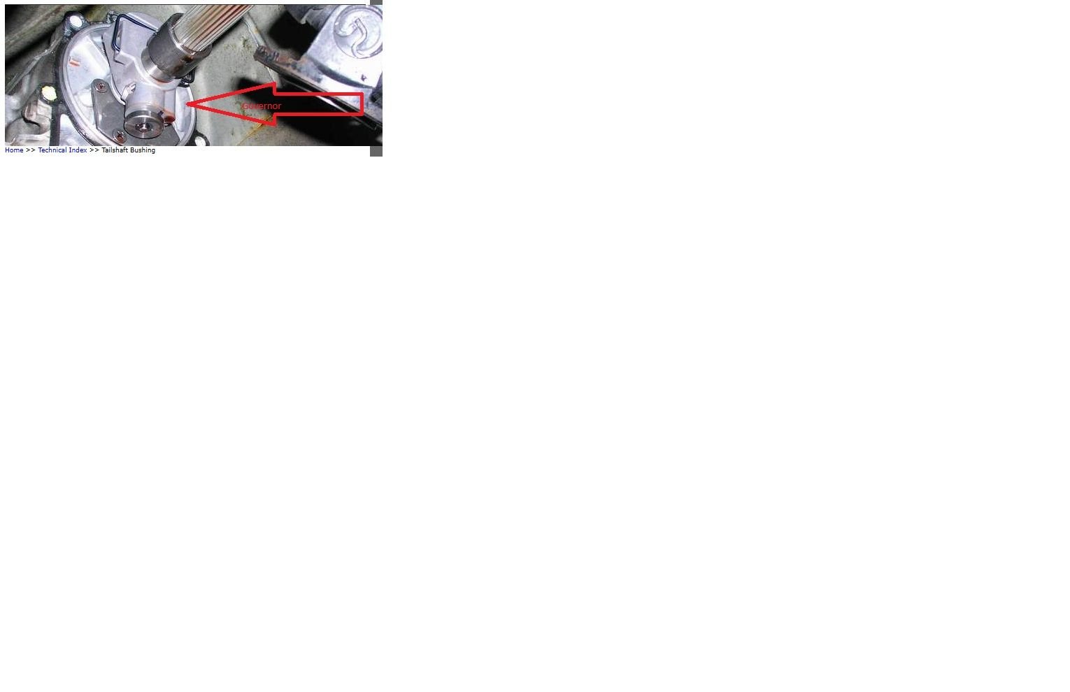

Originally Posted by Janice Gold
Hi Gang!
93 240 Automatic with 133k miles seems to have a mind of it's own when cold. It starts out in 1st but doesn't want to shift up to 2nd unless speed increases and letting off the gas. Once semi-warm, it starts out in 2nd and shifts up fine. When fully warm it will start out in 1st, shifts up thru the gears and no issues.
Any thoughts?
Your transmission has a mechanical valve body and a governor. (#30 on the diagram) I have fixed many weird shifting problems by cleaning the governor. If a sliver of metal gets into it it will stick and cause all sorts of shifting problems. Simple to get to - after you remove the tailshaft housing. Remove it, clean it, and hope no more metal shavings get into it. If it's the valve body - that's not something I ever got into. You will just need a new tailshaft housing gasket a a couple of cans of brake/carb cleaner. Make sure the tailshaft bushing is not worn, hopefully your car is late enough to have a bearing instead of a bushing. And if the rear seal show any signs of wear - it would be a good time to replace it also.
