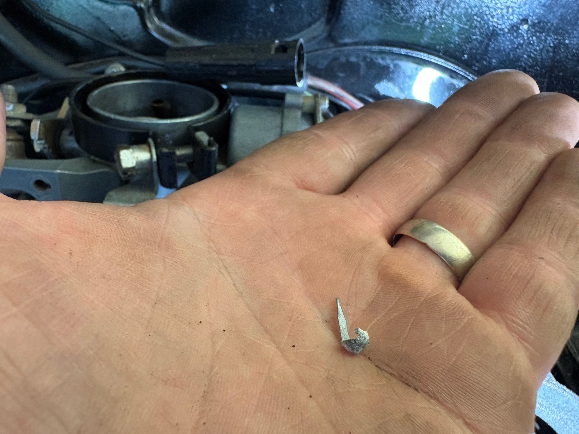

I had a similar issue on a '74 Super Beetle I bought for the wife last year. Everything was original on that car, including the fuses. A few of them crumbled when I touched them. They're an odd German design with no glass - just porcelain with the conductor running over the top and ends of it. That was the cause of the lack of reverse lights on that one. The picture of my hand shows just the conductor minus the porcelain center.

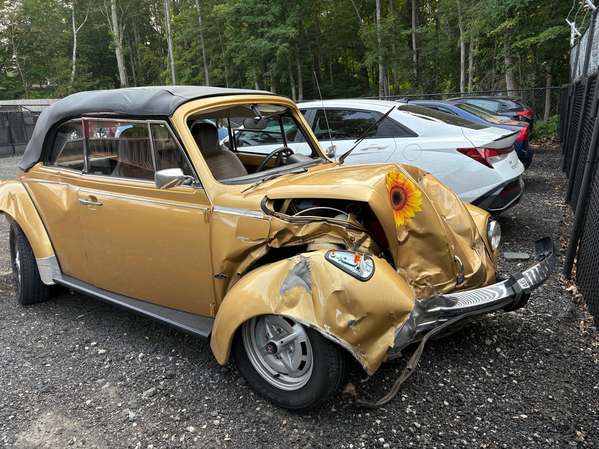

Then as luck would have it the car was totaled last summer after a moron blew a stop sign. Wife got hurt, too. She's almost fully recovered now, but we're done with those cars. We had a 1966 just a month and a half prior, and that one ALSO was a total loss when the engine caught fire! I suspect I missed a bad fuel hose hiding underneath that cloth braiding the Germans loved to use. I think those cars are cursed! At least for us ...

The fuse connector wire end you hold in your hand is exactly what my old Volvo has, all of them of different amperage. It pays to gently snug the ends over the tips of the ceramic/plastic structure before you install them since the connector is loosely fitted. Rather than my fingers I used a needle nose plier to hold the middle of the fuse without any contact with the wire.
