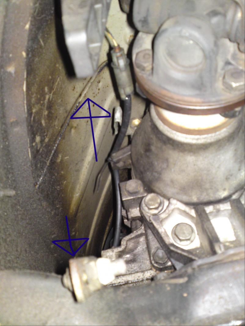

ok so i went under the car and took a couple pictures of the problem. Im just not sure exactly how to connect this rod that apparently came disconnected. Its just hanging down resting on the bottom of the car and has the bushings still in it. Does anybody know what parts I might need to buy and if the metal rod just connects to the hole above it or am i missing another part? thanks!

I can't recall exactly, but there will be a nut and washer one side, and a pin and washer the otehr side for that linkage. It looks like a pin and washer have fallen out. A quick and dirty fix would be to wrap a couple cable ties around it.

awesome, i used a washer and some wire to hold it in place on the other side. worked like a charm!
