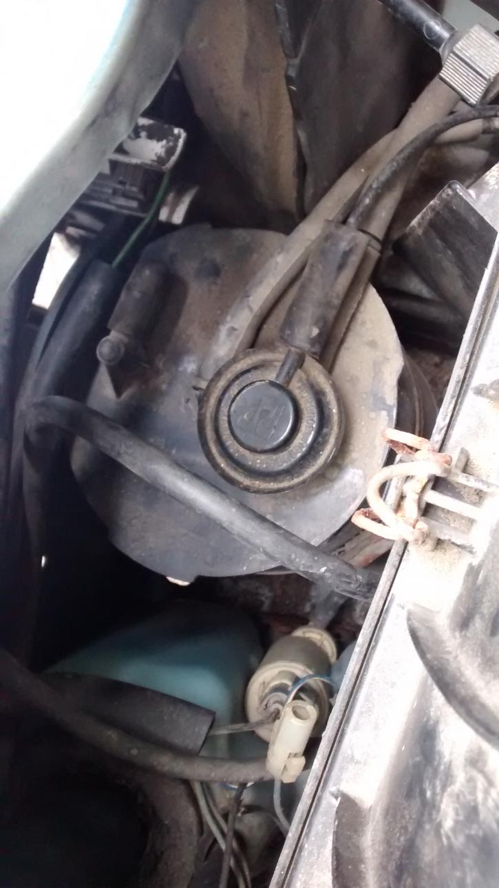

I found one important looking tube that ran down through the T in the line, then got lost sort of into the front bumper, and I couldn't see where it went.
@lev I did find a black plastic tank by the radiator (see picture), but it didn't seem to be attached to the vacuum system, unless I am just bad at tracing tubes. I didn't see anything visually wrong with that tank, and didn't hear any hissing when the vehicle was running.
@act I couldn't find the reservoir pictured in that post, though I didn't actually crawl completely underneath the vehicle.
I did find something that attached to one of the vacuum tubes that looked important, but I don't know what it is (the other picture). Is that related to finding the leak?

First is the heater valve, i guess you have no heater?
Second pic is the charcoal canister, not related to vacuum either.
The thing we want is under the front bumper, it's pictured on the mathew's site act provided.
