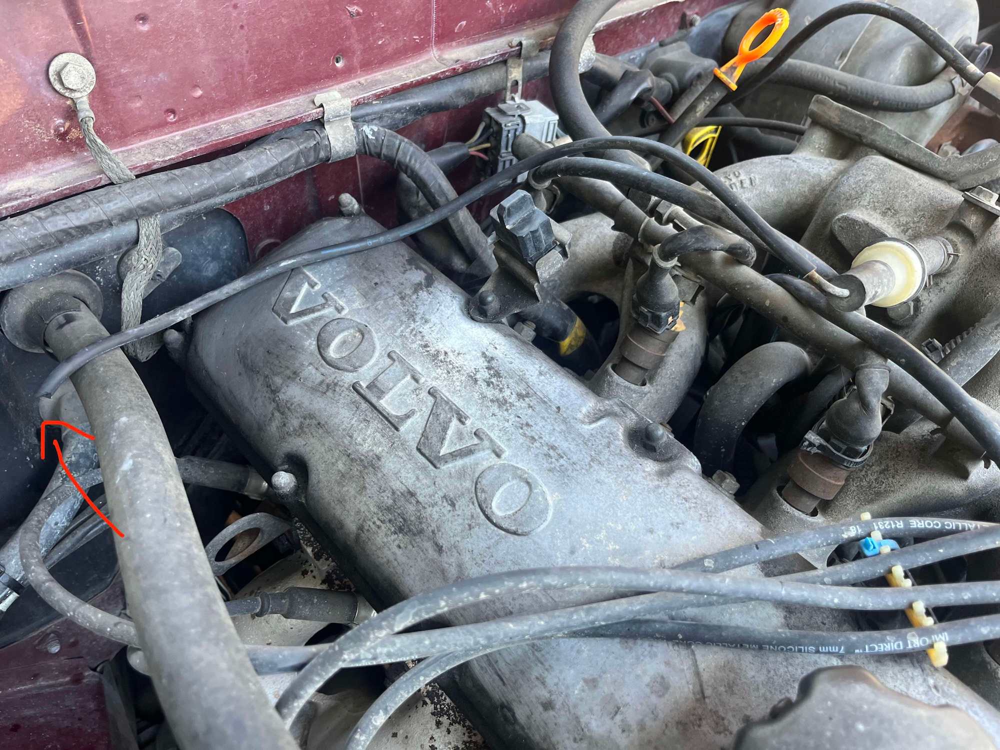

I was just pulling the old girl out of the driveway for her bi-annual smog test and noticed this top vacuum hose dangling. Can someone tell me where this is supposed to go?

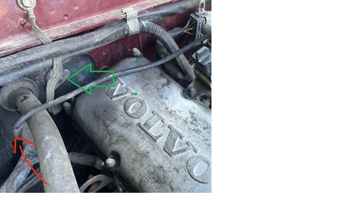

Goes thru that grommet to the vacuum tank used to power the floor, defrost and recirc vents.

Excellent! Thank you!!
