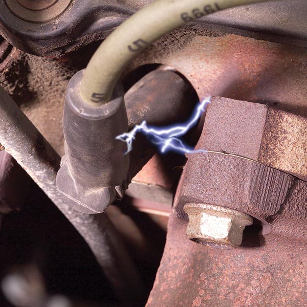

The spray bottle is the mechanics best friend for finding bad wires and distributor caps.
Add a drop or two of soap to the water. The soap acts to allow the water to blanket what you're spraying where straight water tends to bead up and roll off.
Attached Thumbnails Car dies when wet, backfire, etc.-spark-plug-wires-arching.jpg
