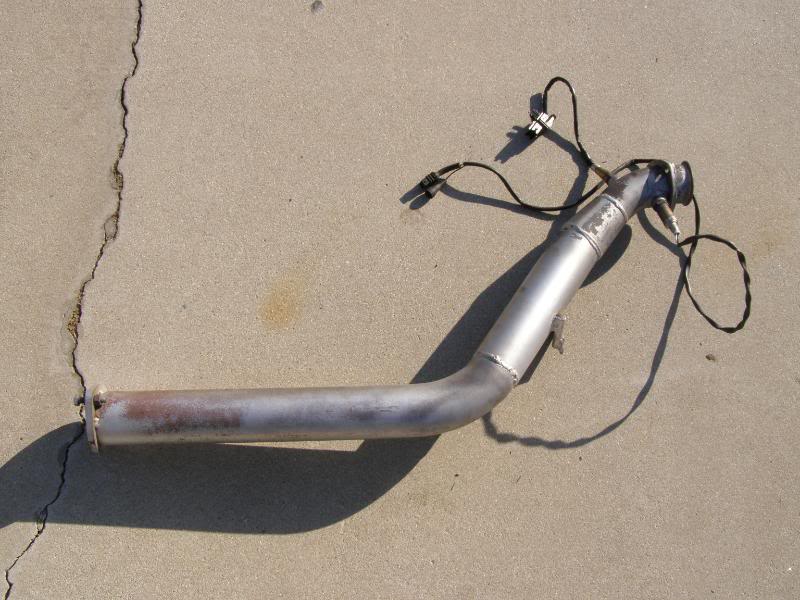

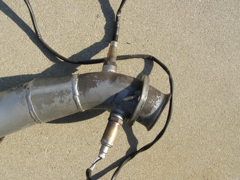

Yep. It is the same size as what Brent did for the transition on the new downpipe:
2.5" to 3" transition.

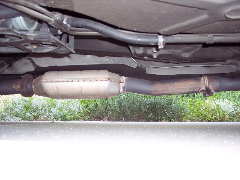

Here you can see the old system. after the cat it drops, if i remember correctly, from a 2.5" to 2.25"
hope that helps.
