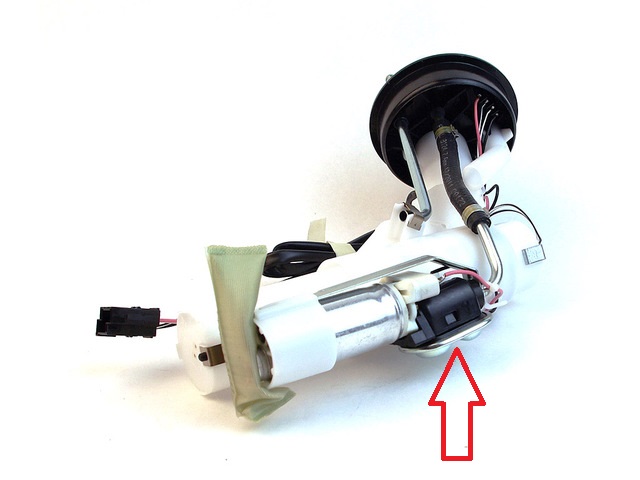

there is a part of the fuel assembly on my car that i dont see on other assembly's between where there should be a hose that goes to the fuel pump to the fuel pump assembly primarily the one that put out fuel to the engine.
i instaid of having a hose have this part thats like a metal/plastic piece it has 2 humps on it and rubber orange material inside.
i wonder if i should have removed that piece and put a small piece of hose instead of keeping that on?
arrow is pointing to what im talking about, it doesnt seem like it would be as solid if i put a hose between the fuel pump and the hose on the assembly part maybe its not holding pressure cause the need to once trying to start having the fuel pump to reflow fuel from the tank to them engine causing this prolonged start?
another thing i thought was kinda odd was the quick release valve that you pull and it releases the grip on the nipple, i could just slip it off with my hand, i noticed no leaks though at the assembly before i took it apart, but that doesnt mean its not, not holding pressure.
