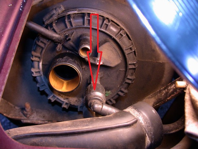

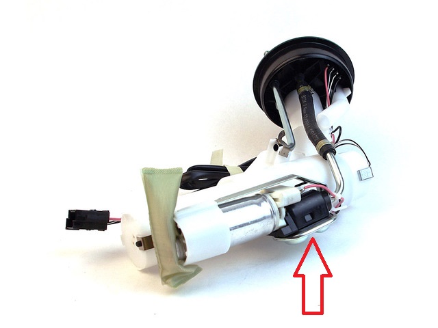

Problem Solved: Quick Release Valve for the MAIN Fuel Line at the fuel Pump Assembly.
I also went in and removed this piece and put a straight pie of fuel line hose in its place. and clamped it down.
has has been start right up on the fist crank.....Very Happy as this problem was nothing short of drivng me NUTS!
