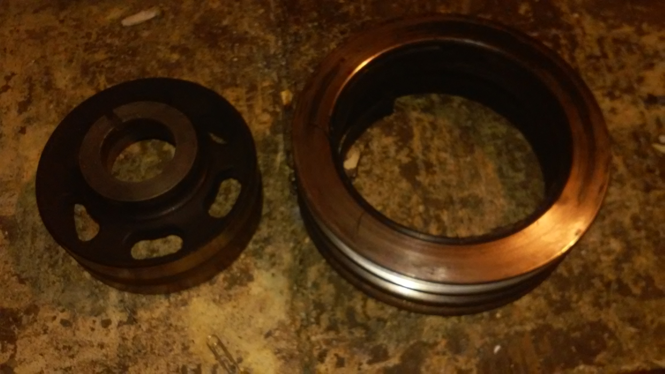

most likely it's fine. no timing issue. may be some mechanical damage, hard to say until you get into it. new cover?

So many harmonic balancer looked like this...2 pieces. It wore a huge groove in the lower timing cover.

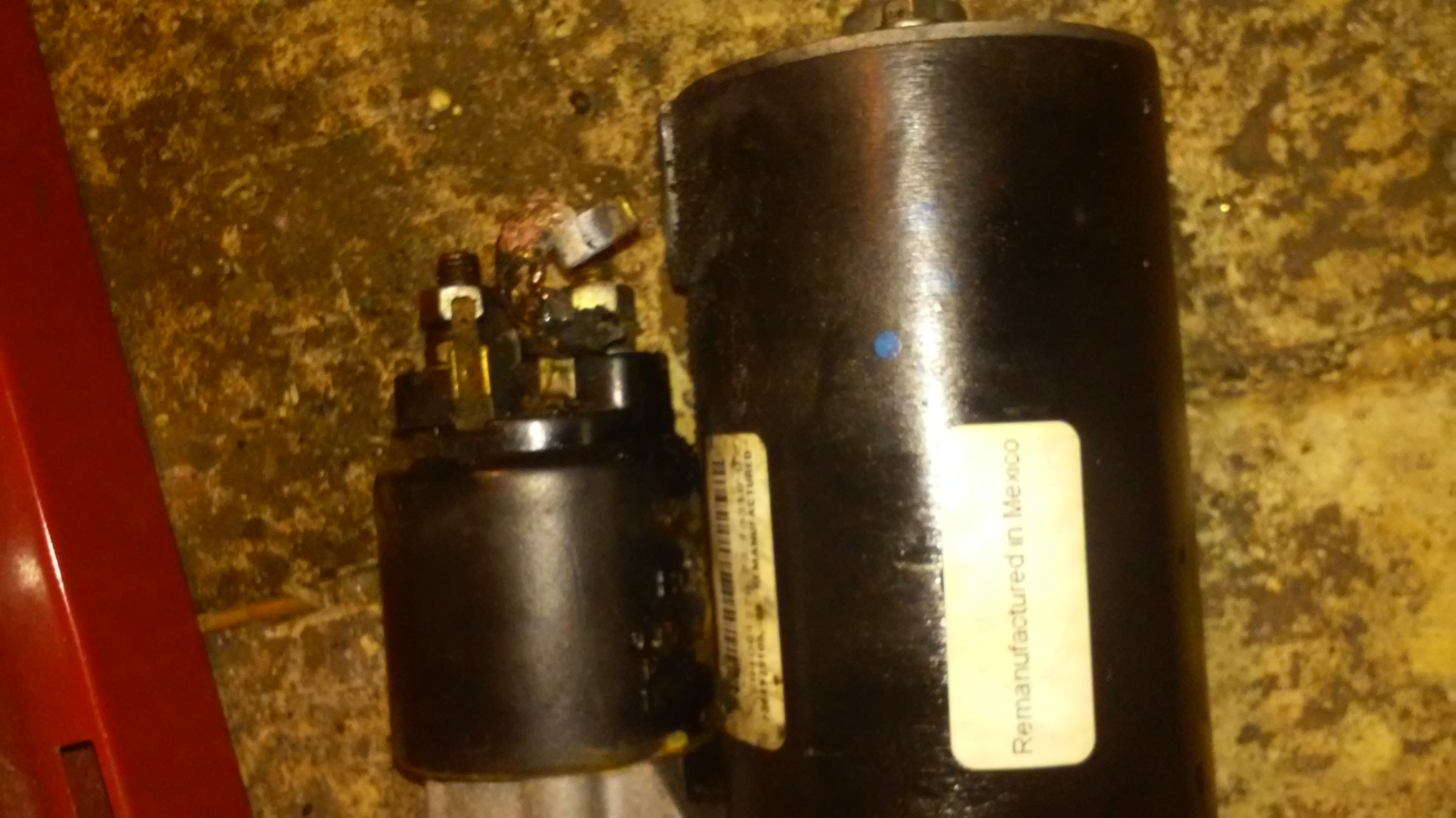

As i was working on this i discovered the insulation on the wiring for the iac, tps and starter was melted.
So now im in the process of switching starters...again...the reman starter i bought and installed looks like this. That strap from the motor to the solenoid in white and not attatched. I don't know if the problem started there but something happened somewhere.
It might well have been what caused the car to quit.

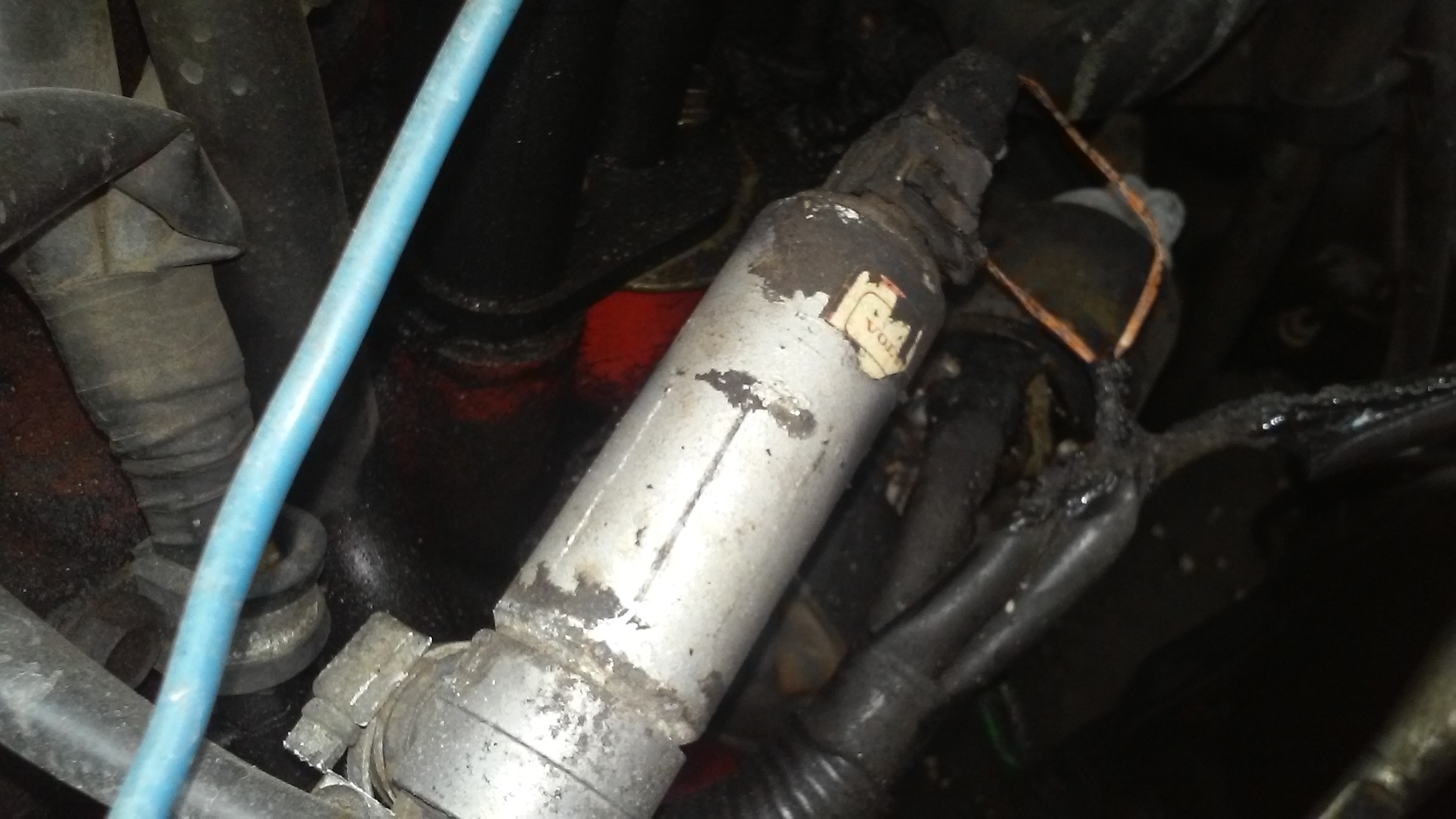

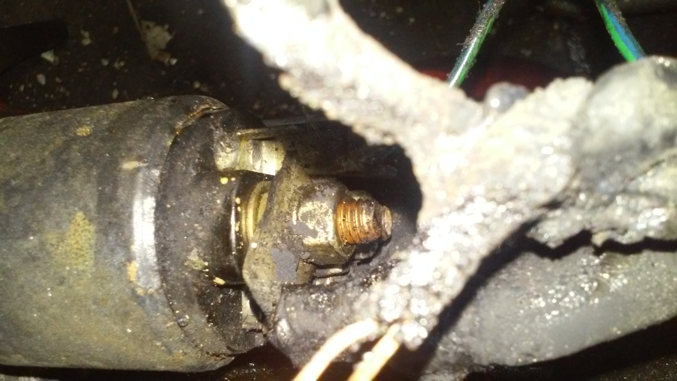

The wiring for the iac and tps looks like this

Ouch! Not good. Something caused these wires to melt--probably some overheating or a minor fire in the past. Normally1992 don't not suffer from bad wiring. These wires should be repaired or better replaced. I wonder what other wiring is similarly damaged?

The fire damage to the insulation apparently didn't break any of the actual wiring.
