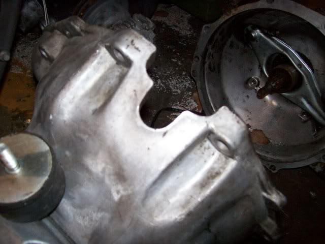

thanks,, i will begin with your suggestions, one question, the crank sensor , where is it located? i looked in my haynes repair manuel and i can't find any referance to a crank sensor..

The crank sensor mounts to the back side of the engine where it meets the bell housing of the transmission. Right at the top of the bell housing. Fortunately, crank sensors have a rather long pig tail on 'em so you can access the connector rather easily. There is a cut out on the back of the bell housing that looks like this...
The crank sensor mounts to the rear of the engine and protrudes into the opening shown on the bell housing.
