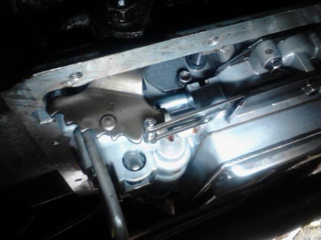

Well the linkage must be right because the car is in fact in park and i kept the pan off hanging to observe the locking plate mechanism and the gear inside that moves.
Based on this picture and the fact that the car will not move when pushed forward, I'd say that park is at least right...
But, it must still be off since the shifter no longer will go down past the 2 gear to 1.
I believe the shifter can be moved without the linkage in the pan moving, or the other way around.
is this right?
