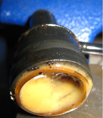

Thanks for the help... I pulled the oil trap and while it is not totally clogged, it has build up about 1/4" all around allowing for a lot less flow of air. I ordered a replacement. But I am perplexed, upon removal of the oil box, I noticed a silicone sealant was used to install the last box. The sealant was a clear sealant and not like any high temp sealant I have seen. The sealant was only used around the oil return tube(I think that is what it is called!) and not used around the o-ring. Should I use a sealant as well?
The picture below shows the "clogged artery" on top of the oil box, air flow is still present, so I hope I am on the right track
This image shows the area the silicon sealant was applied around the hole on the left

You should not have to use sealant, just the o-ring.
