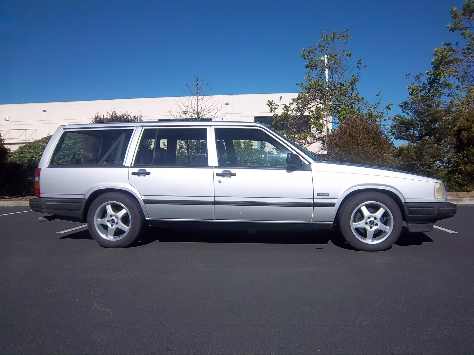

Anything like this would look good, but you're gonna have to lower the front end and get rid of that "nose up" look.

I liked the looks of the turbo 'Hydra' rims on my 740 T... most aftermarket rims look pretty tacky. going low profile just harshes up the ride.

Everybody has their own tastes and interpretation of "beauty". I think the best looking rims ever for 740/940's we're the Borbet(first) and Polaris(second-and were a factory option) rims made exclusively for them. Sadly, no longer made. An easy trick to lower the front end without stiffening the ride is get some standard, non Turbo front springs, which have an 85 lb spring rate and cut off 1 coil. That will drop it an inch and bring the spring rate up to 90 lbs, which is the standard rate for Turbo springs.
