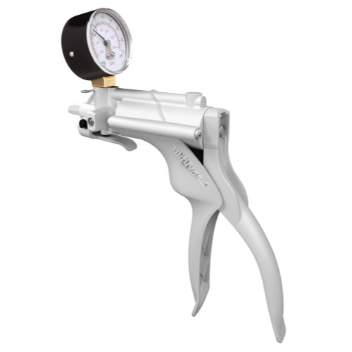

Thanks for the thoughts, I have what looks like an OEM valve (in my 740) and it is oriented correctly (thanks). Is there a way to perform a vacuum test without a vacuum gauge (cause I don't have one)?
Old Dec 7, 2013 | 05:44 PM
only way I know of is to use a mity-vac, which is a little handheld manual vacuum pump (looks a little like a gun with a pressure gauge on the end), find the main vacuum line from the engine to the MCC,and hook the mityvac up to it and pump it down a few pulls and see how fast it leaks out (in?). flip the flap controls to the various positions, and repeat. a little loss is ok but a fast leak such that you can't pump it down is not gonna cut it. and yes, when you flip a control setting that will require moving flaps, it will take a bunch of pumps to suck enough air to move the flaps.

Default ok, then I will get a mighty vac!
thanks
Old Dec 7, 2013 | 06:01 PM
mity-vacs usually come in a kit with a bunch of tubing, and a pile of adapters, all of which can be handy for different things.
the pro models are more expensive and are metal, but for amateur use, the plastic ones are just fine.
