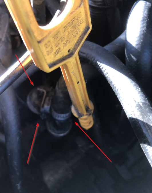

Hello, this is at the back of a B230FK engine on a 1995 940 built in Sweden. This part which has red arrows pointing to it is next to the dipstick for the transmission oil. It is connected to a hose, and appears to have some kind of valve attached to it. Would you happen to know what this part is, and what it does?

Heater control valve - the plastic gets brittle and they snap in half causing quick loss of all the coolant then the car overheats and damages your head gasket. You don't have to have one if you live in a cold climate. It only turns off (with vacuum) when in recirc mode I believe or when requested ac temp is maximum cold. It's open all other times and the blend door controls the air temp mixing fresh or cooled air with heated air.
Grab it and see if it breaks apart - you want it to break in your driveway - not while driving.

Sounds like an added risk. I can remove it, if I don't mind not having recirculation mode, or having the ac temp to max. I read they may be compatible with metal AC Delco/GM part. I'll disassemble and examine what shape it is in.
Thank you!

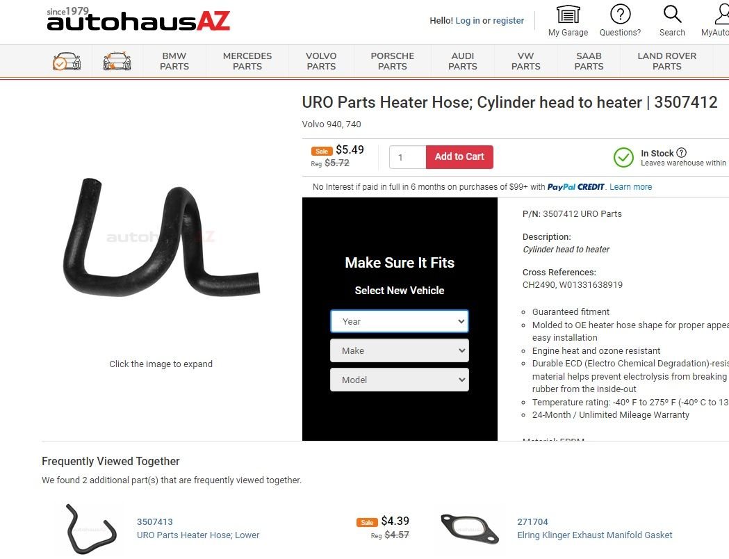

The heater valve is attached on both ends to a heater hose. That hose new is actually one piece that has marks on it where to cut to insert the valve. Cheapest thing is just put a new hose (or both new heater hoses when you are there) and leave the valve off.
Might be a 3507412 and 3507413
