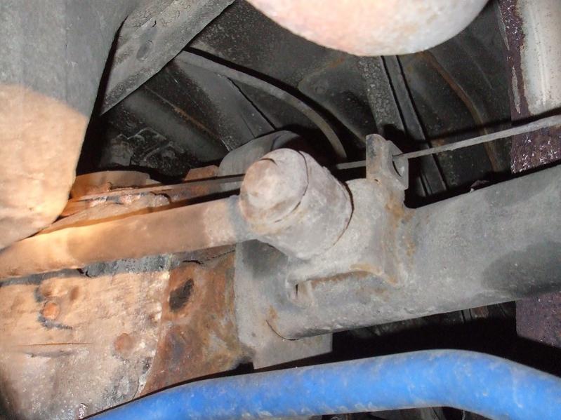

Here is a picture where the panhard rod is on the bottom left and it is supposed to be where the silver dot is, I am hoping it is just a bolt or connecting piece that broke and I can replace. Thanks

You're in luck. That's a removable albeit broke bolt. Will probably need to drill it and use an EZ Out to remove it. I have a couple of 740 complete rear ends at the shop; if you have no luck locating the bolt locally or Volvo wants $50 let me know and I'll mail you one.

It looks like a pin was attached the frame and the panhard rod slid onto that with the bushings and then a bold held it down. Does anyone know how the panhard rod is supposed to attach to the frame on the rear passengers side on a 1992 volvo 740? Thanks

Does anyone know how the panhard rod is supposed to attach to the frame on the rear passengers side on a 1992 Volvo 740?
It does not. The driver's side attached to the frame. The Passenger's side attaches to the axle. There is no pin. What happened is the bolt sheared. The silver dot is what's left of the bolt on the car. You need to remove that and then put a new on in it's place.
Swiftjustice44 said exactly what you need to do. I you are clueless as to what to do with an EZ out, have a shop do it. If you go the EZ out route don't forget a penetrating oil.
