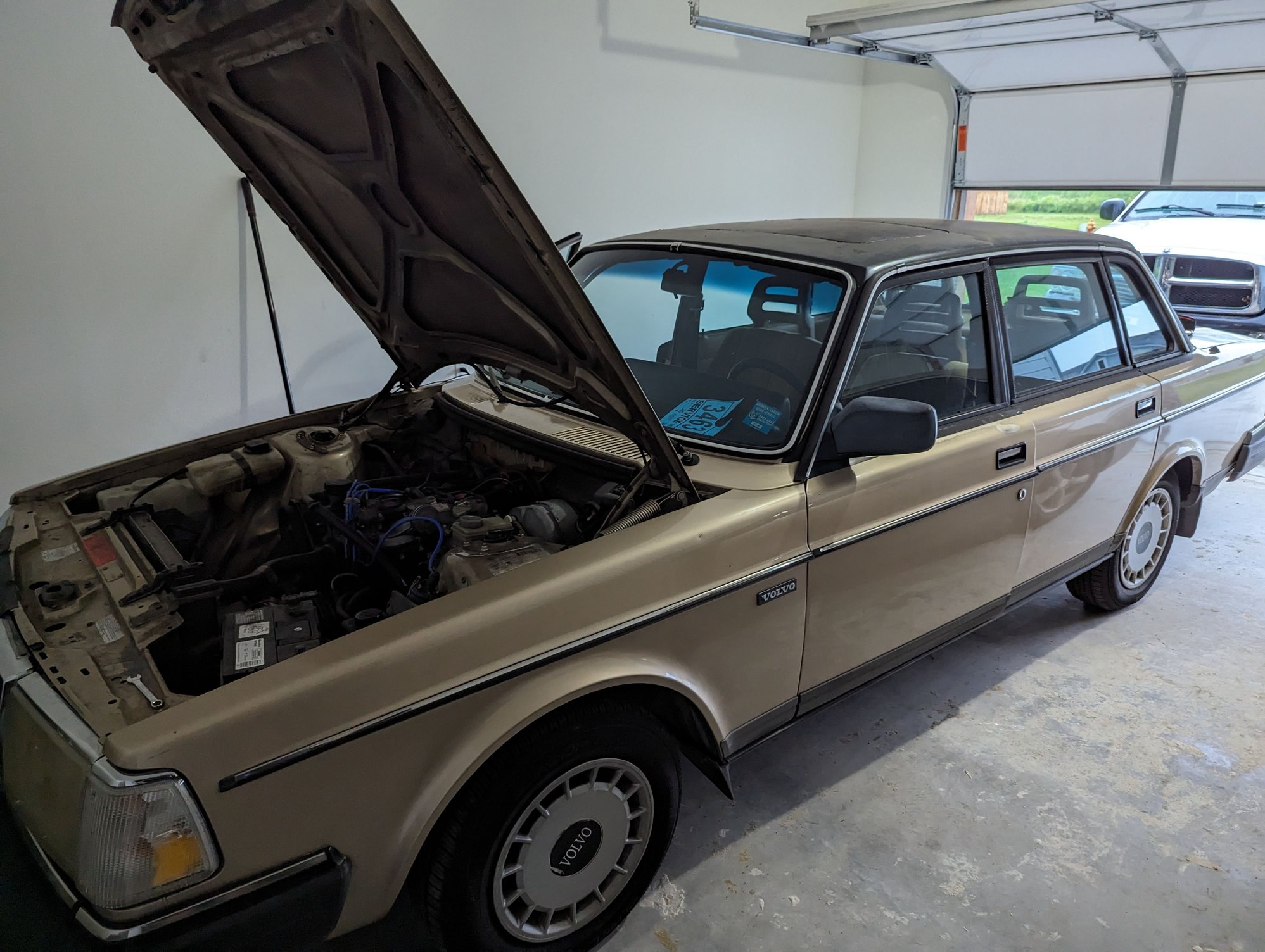

Hello, new here. No experience with Volvos, but plenty experience in the automotive repair field.
I have just recently purchased a 1990 Volvo 240 DL sedan.
1990 Volvo 240 DL that won't run
I got it from my boss for practically nothing because it won't start. I am making this post because following the advice from other threads with the same or similar issues has gotten me nowhere.
The previous owner had replaced a ton of parts trying to fix it before giving up. The list of parts he replaced that he gave me were:
Injectors
Spark plugs
Ignition coil
Ignition control module
Crankshaft position sensor
ECU
Fuel pumps
Fuel filter
And replaced timing belt
He also said that there were no codes on the diagnostic module. But nothing worked.
I bought the car thinking it would be a little simple thing he overlooked. Boy was I wrong so far.
I have replaced:
All the fuses (and cleaned all the contacts of corrosion)
System relay
And the plug wires
Now to the diagnostics I have done. The car cranks just fine, but will not run. It will sputter on one or two cylinders for a moment and backfire. I checked the firing order and it was correct, but discovered the wire to the distributor from the coil was bad, so replaced the plug wires. Same issue. I checked the timing of the timing belt was correct, and all the timing marks lined up. I used an inline spark tester and it showed a good spark. I hooked up a noid light to the injectors and got nothing. I followed the wiring diagram from Alldata and tested the wires to the injectors from the ECU and relay and they had good continuity. I checked that the ECU was receiving the engine speed signal, and confirmed it was. I checked codes myself, but only got a solid red light instead of any codes. When I opened the oil fill cap it smelled like gasoline. Reading other posts the ECU could be bad then, but I'd like to not spend a ton of money yet if I am not absolutely positive of that being the issue.
Everything I have done has got me no closer. Any advice or tips would be appreciated.
