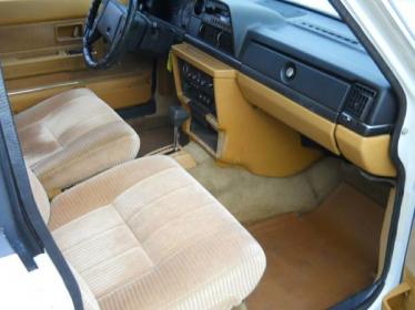

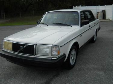

I am very interested in buying an older 240 and I found this one online.
Maybe someone could give me an opinion on it and what to look for when checking out the car.
Thank you very much!
1987 VOLVO 240DL SEDAN.ONE OWNER FLORIDA CAR WITH A CLEAN CAR FAX.ALL ORIGINAL WHITE EXTERIOR PAINT.TAN CLOTH INTERIOR.EXTERIOR PAINT AND BODY RUST FREE.INTERIOR IN EXCELLENT CONDITION.CAR RUNS GREAT NO OIL LEAKS.ALL POWER OPTIONS IN WORKING CONDITION.130,000 MILES.

the tan plastic interiors are prone to cracking due to age, first piece to go is usually the cover on the inside of the "B" pillar between the front and rear doors.
the cloth seats are a LOT more durable than the leather ones were (our white+tan 87 is leather).
obviously, that car is going to need a new right headlight ASAP, its badly yellowed, but these are like $100 and 10 minutes to install.
otherwise, what rspi said. look for bad insulation, signs of amateur electrical repairs under the hood. thats pretty low mileage for a 25 year old car, ours is somewhere north of 400,000 miles.
