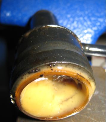

I have a '92 740 B230F and I recently noticed that the large vent hose for the flame trap had a decent size split at the trap end. When I went to replace the hose I then noticed that the flame trap was completely blocked with some substance that I didn't realize a car could produce (See picture attached).
The substance is a pale yellow and has pudding like consistency. My question is, is this a 'normal' clog that would result from having a split in the flame trap hose? If so, would it be worth replacing the oil trap in the future? Assuming that it too is clogged?

What does it smell like? Oil, coolant? That looks like an oil and coolant mixture, which should not be in there(the coolant).

Yes, it looks like there is coolant in the oil which is a sign of a blown head gasket.

Condensation build up in the crankcase. Usually not a problem. Comes from taking to many short trips . How does the inside of your oil cap look. Replace the flame trap and hoses. Change the oil and give it a good run.

I do take a lot of short trips these days. I checked the inside of the oil cap, seal looks good and inside is clean, oil looks fine too. I'll swap out the flame trap assembly with a new kit and try and be better about checking it with every oil change.
In regards to the condensation in the crankcase, what are the likely points of entry? Oil filler cap and head gasket? I guess sometime in the near future I should run a compression test to check the condition of the head gasket.

It smells like oil. There may be some hints of coolant but it's hard to say as the oil smell is strongest. Someone had posted about the head gasket leaking. I will try and test this theory when I get a chance.

This is more common than you might think. A weather change from warm, moist weather to cold weather or repeated frost (condensation) on the vehicle and frequent high dew points can create moisture to form in the crankcase. This can appear as condensation in the oil system and under the valve covers. Most of the time vehicles are driven long and far enough so that this condensation is burned off thanks to the heat of the engine. However a vehicle that is not driven very far and does not reach full running temperature for very long may not purge out the moisture. Vehicles that are not driven frequently and sit outside can also acquire moisture in the oil system. When these vehicles are driven, the engine generates some heat during the short drive, then cools. The trapped moisture condensates on the coolest part of the engine, the valve cover and oil cap. Repeated short trips will leave behind more and more moisture on these cooler parts. You then open the cap and discover this milky white buildup of creamy mocha colored slim.
