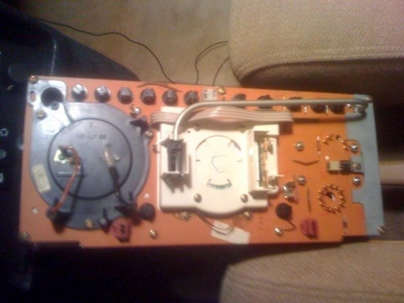

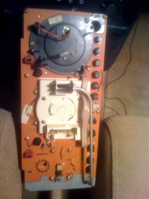

where da gear?

This is Art Benstein's writeup:
http://cleanflametrap.com/speedo5/
