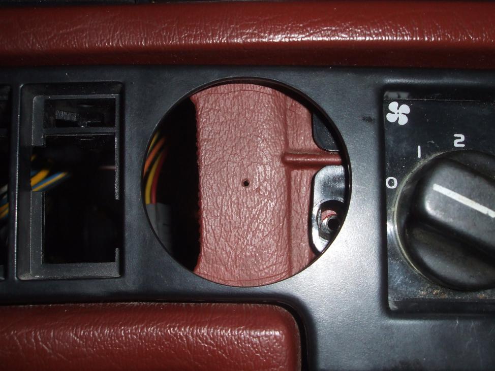

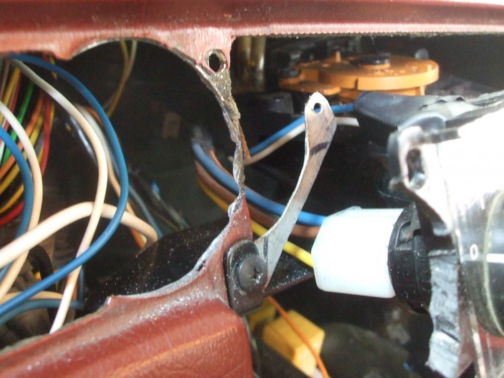

The gauge is in the space between the climate control and the Sunroof switch. It was a very tight fit and left very little room for error. Cutting the plastic trim right was tough. I had a few spares from junks yard to practice on. The second one turned out perfect. I got it right in the middle of the top and bottom edge and as far to the left as possible to keep it away from the climate control. I had to cut the main clipping device for the trim out, but I'm going to fasten it a new way later.
You can see the tight fit against the climate control. Most of the member got cut out, so I made a plate out of some stainless to span the gap and be out of the way. It also the anchor for the screws that hold in the climate control in and the radio box:
Here's everything after all the cutting:

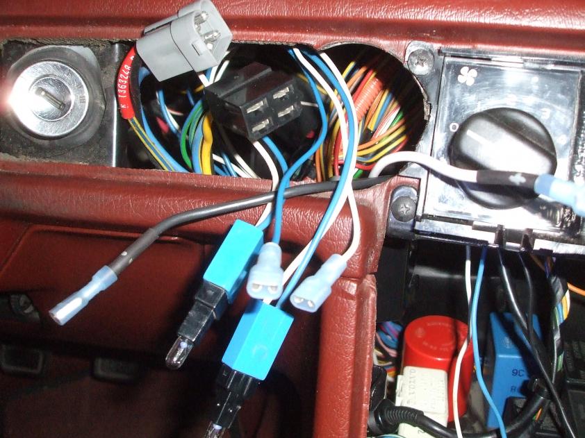

Power for the Gauge is connected to the back of fuse 13. Nothing in my car's configuration was connected to that circuit and it met the power scheme requirements. I also grounded to a grounding rail in the back side of the fusebox. I had to make a spare connection:

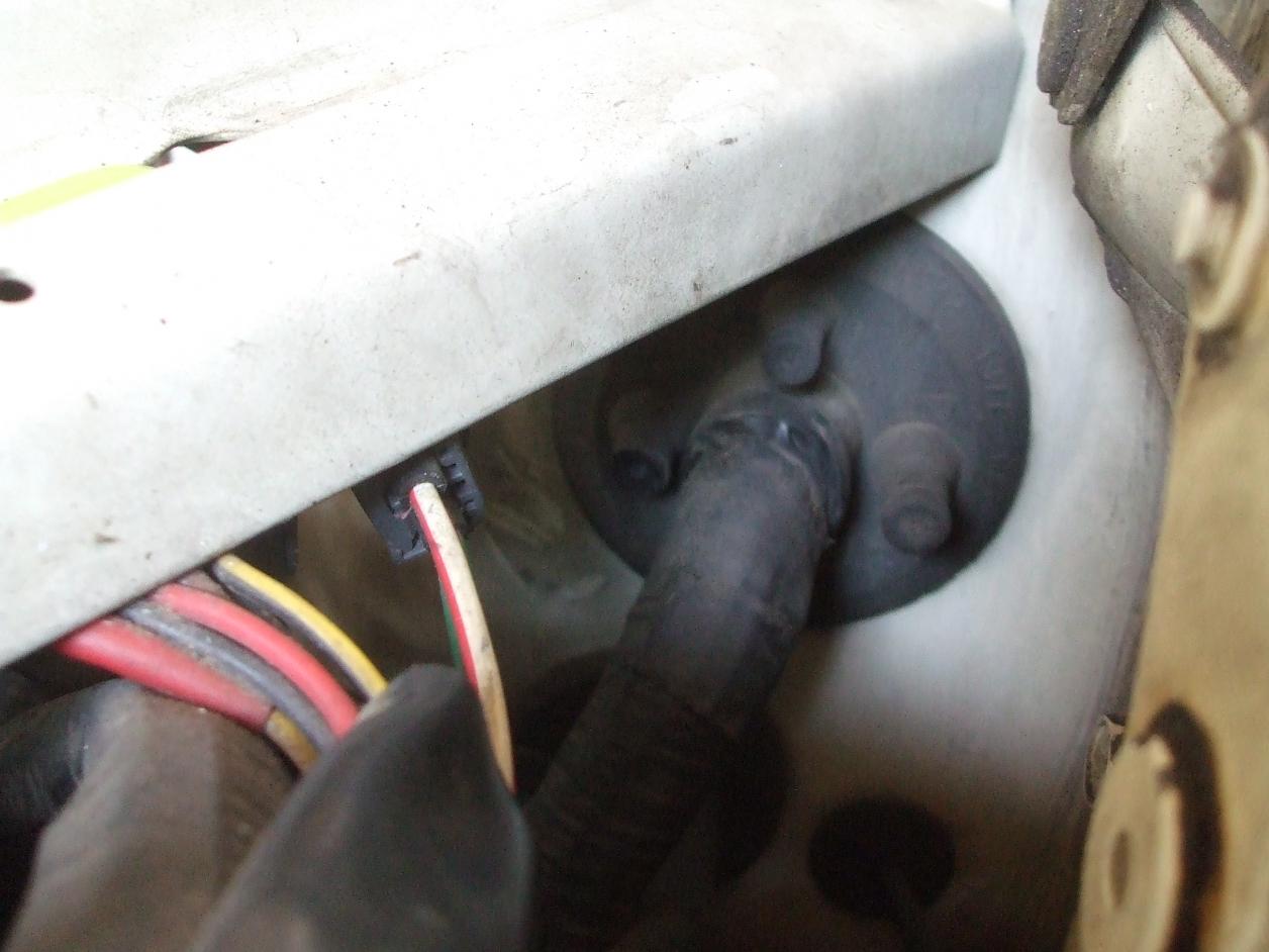

Here's where I went through the firewall. There's a big grommet under the strut tower buttress. It has some small nipples that are not being used and a ridge marking where to cut them off. I little snip and the wire was in the car.
Five wires total to run, here's how they turned out:

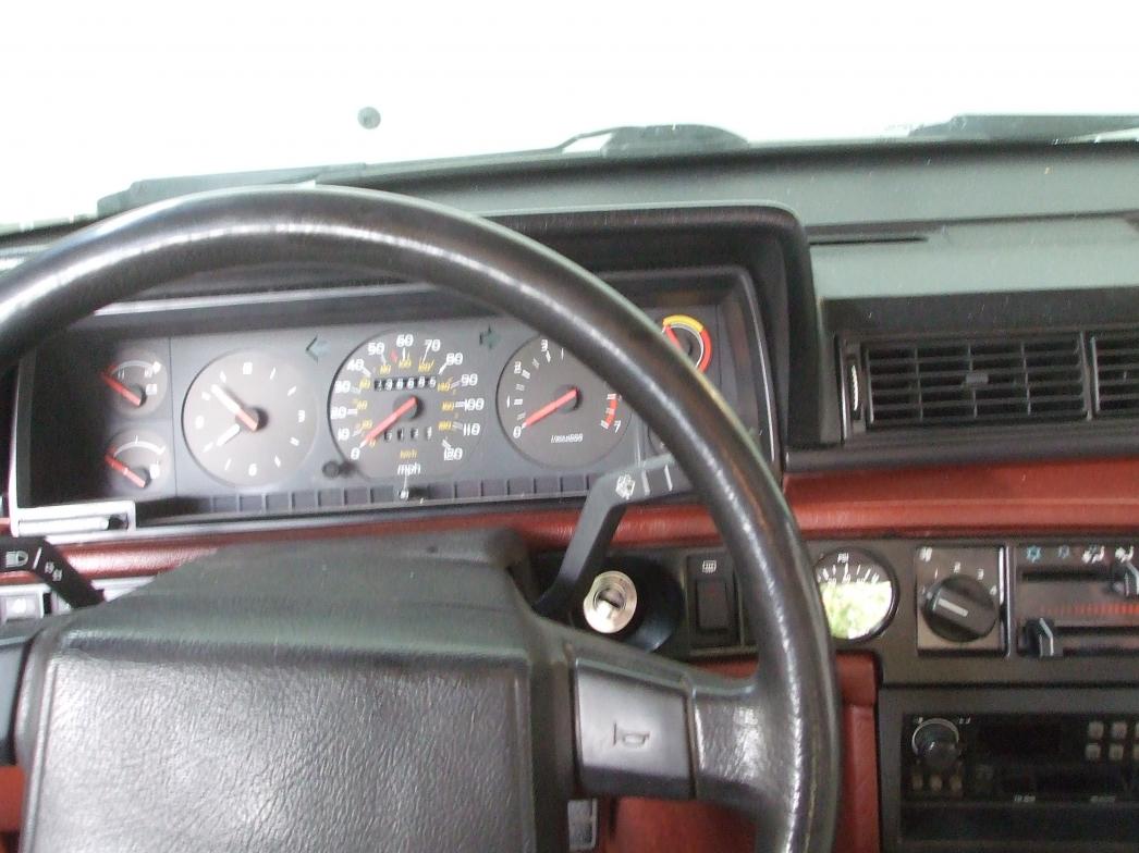

This is everything before the trim is snapped on. You'll notice a plate around the gauge. I wanted the gauge to be recessed behind the trim, to that it what it tightens into, as well has the hole in the dash. I also angles the gauge to better match the angle of the trim.
So one more look at the final product:
Actually, I'm going to go back and make a clip to make it hold down better and a custom gauge face to match the rest. I have a few spare gauges too, so I might see if one of those needles will swap onto this one. But that's for later.
One thing that I have noticed is that the new gauge is a bit brighter than the gauge cluster. I might throw in a resistor to tome it down a bit. But I've been really happy with it. On a hot day at idle it will get down to 25 PSI, but I never see it go lower.
